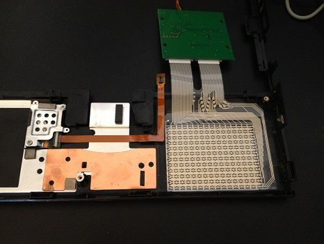

few months ago did a touckpad mod for an x61s.
http://forum.thinkpads.com/viewtopic.php?f=30&t=113605

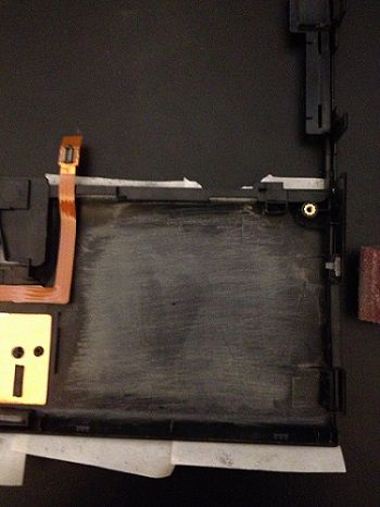

This time decided to do a hidden touchpad. The idea is to make the palmrest touch sensitive itself.
After some search found the needed sensitive film with controller board by Circus . Unfortunately, it turned that this line of product is out of production. I started calling all the retailer of Circus and found one guy who had a single one provided as a sample. He agreed to sell it to me. So finally got it for about 50 euros.
So here is the mod.
the touch film and board
http://i131.photobucket.com/albums/p301 ... 153226.jpg

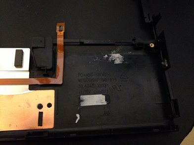

the inner left of the palmrest
http://i131.photobucket.com/albums/p301 ... 154257.jpg
same after sanding
http://i131.photobucket.com/albums/p301 ... 155358.jpg
film attached

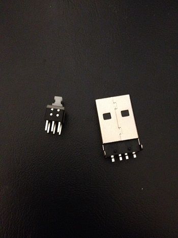

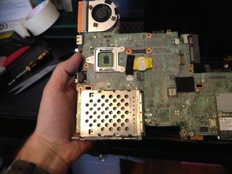

bye - bye pcmci cage
http://i131.photobucket.com/albums/p301 ... 162522.jpg

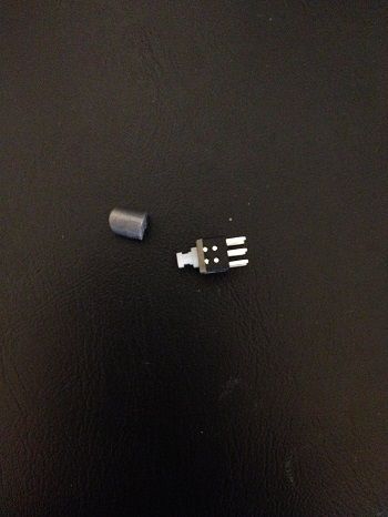

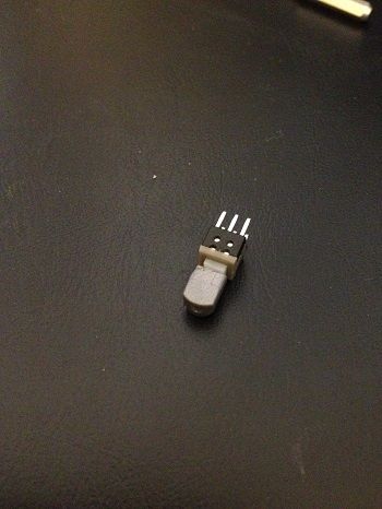

using tip of pcmci eject stick as an on/off switch for the touchpad
http://i131.photobucket.com/albums/p301 ... 172153.jpg
http://i131.photobucket.com/albums/p301 ... 172752.jpg
http://i131.photobucket.com/albums/p301 ... 174639.jpg
http://i131.photobucket.com/albums/p301 ... 174705.jpg
glued the pcmci door from inside

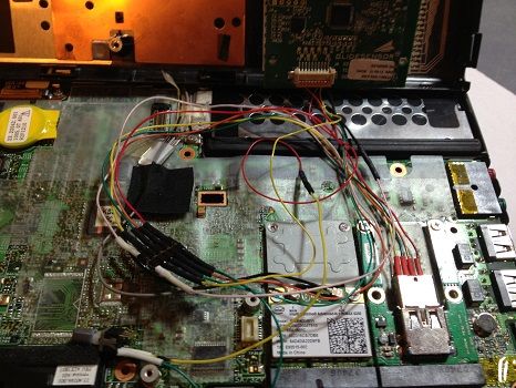

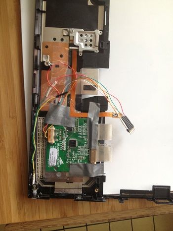

wiring
http://i131.photobucket.com/albums/p301 ... 230250.jpg
http://i131.photobucket.com/albums/p301 ... 002048.jpg

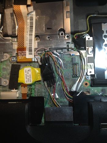

everything on its place
http://i131.photobucket.com/albums/p301 ... 145017.jpg
http://i131.photobucket.com/albums/p301 ... 150529.jpg

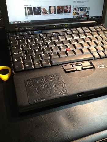

attached a piece of leather to mark the dimentions of touch area
http://i131.photobucket.com/albums/p301 ... 173743.jpg

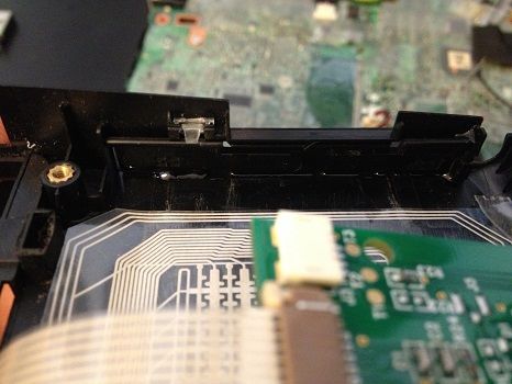

the main challenge was the fitting of all into x61 body, especially considering that the film is sensitive from both sides and if something is contacting it from behind it is becoming glitchy. So finally had to make a small bridge over the film to place the controller board in the same area without having them contacting.
the result is cool. Touch is quite advanced with scrolling, zooming, and tons of other configurations that I never use ;)

It's called Cirque GligeSensor HTS900-1032
Got it from here http://www.maxi-electronic.de/texte/navinh.htm
The driver is this http://www.cirque.com/desktoptouchpad/drivers.aspx

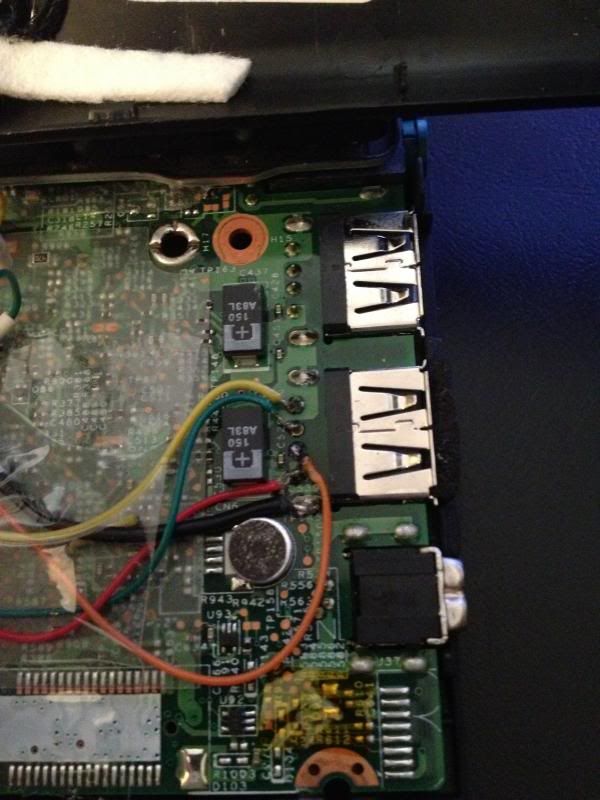

I have used a simple mpcie to usb 2.0 adapter from ebay (you need to have Midleton BIOS).
the adapter is this one
http://i131.photobucket.com/albums/p301 ... w60_12.jpg

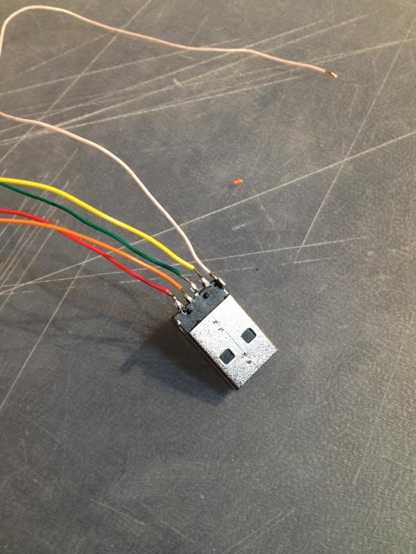

the tip
overall looks like this
The connector on the wires is not really necessary, did it for convenience.
or you can solder the usb contacts to the pins of one of your external usb ports.
http://i131.photobucket.com/albums/p301 ... 125123.jpg
In this case you will need to block the usb port from outside because it won't be usable.
As i mentioned the sensor can not be contacted from behind. I bent a metal sheet to make a kind of a bridge over the sensor to attach the board in the same area (See the detailed pics in the initial post). When the PCMCI cage is removed you will have 7.8 mm height to place the board. If the bridge has 1-2 height then everything will fit. Personally, I would love to see it in the middle of palmrest (or at least at the right), but the glide sensor is too wide to be placed there and as the right hand side is also busy with mpcie ports the only alternative I could think of was the right hand side.
Of course you can find a better fitting option.
The on/off switch is on the 5v power wire. BTW, the switch is really needed.
I chose to go hard way and put it where the PCMCI eject button was, but you can put it elsewhere. For example in place of telephone line port.

replaced the leather with thinner vinyl sticker.
http://i.imgur.com/0skUFLy.jpg
http://i.imgur.com/EyvepH1.jpg
I think this one looks better
