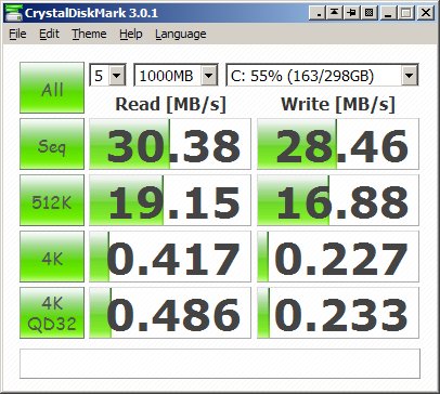

This is what I got yesterday when running CrystalDiskMark on my Ultrabay-connected Seagate ST320LT012 SATA drive. After setting up this drive last month, I noticed that it was listed in the "Safely Remove Hardware" utility. I didn't think much about this until I looked into how Windows XP had it configured (Device Manager/Disk Drives/Properties/Policies: Write-caching enabled and Optimized for performance. Thinking that this would affect the disk benchmark, I disabled both settings, waited a few seconds and then commanded Windows to shutdown and reboot. The shutdown appeared to go fine but it never booted :( . I had exactly the same problem last month with my PATA drive, but without changing anything in Device Manager. It was some time since I had re-booted the system and decided it was time. It was slow to shutdown and the subsequent re-boot never took place. All I got then and yesterday was a blinking cursor after the IBM splash screen.
I had tried a number of things with the PATA drive to get it to boot again; FIXBOOT, FIXMBR, using a Windows XP install disk to run a repair. Nothing got that drive to boot. When mounted on another system all of the files appeared to be there. Scandisk reported some errors and seemed to fix them but still no boot. It was then I thought about using a SATA drive so I cloned my PATA backup drive onto it, copied all of the updated files from the now non-booting PATA drive and all seemed well. For about three weeks anyway. At this point I'm not sure if I'm going to continue using the SATA drive. I think I need to figure out why two different disk drives, mounted in two different ways, failed exactly the same way. I've got a strange feeling that something in the software (i.e. Windows) is amiss and is causing this, after all, both the SATA and PATA drives originated from the same disk image.
I recently ran memtest86+ on that system for a couple of hours and it passed so I believe the memory to be okay. I've had some strange issues with this A31p over the last two years so then again maybe it's the hardware. In any event I will probably not be able to get a disk benchmark on a PATA drive right away. I'm going to clone my last PATA backup onto another drive as I don't want to disturb the backup. I am also thinking about swapping my main A31p with a backup system and seeing how it performs.
