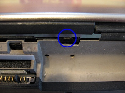

The magnet for the Hall-effect switch is located beneath the keyboard bezel, in the "well" under the lid. Here's a photo of a pushpin dangling by a thread that points to the area where the magnet is located:
<-- Click for 300KB 1024x768 image
Remove the battery and look here:
<-- Click for 238KB 1024x768 image

Oh yeah, I see that spot now. I guess mine must have fallen out at some point or something.
Man, that's a tiny magnet. Must be 2mm x 2mm x 1mm. Guess I'll keep an eye out for one.
Thanks.
Thanks.

Try finding a defective IEM (In Ear Monitor) earphone. Those things usually have small rare-earth magnets inside.Sweater Fish Deluxe wrote:Man, that's a tiny magnet. Must be 2mm x 2mm x 1mm. Guess I'll keep an eye out for one.
