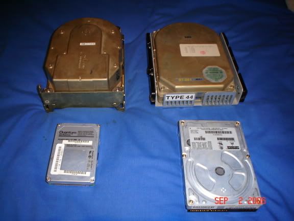

I remember back in the '80s when I spent nearly $700 for an 80MB Seagate ST-4096 full-height 5.25" hard drive.
That's right: MB, not GB!
It was for my first home-made desktop with 386/25 CPU, which I was updating from a half-height 20MB Seagate ST-225.
Seagate ST-4096 is the top-left monster.

UGH. Most of those ST-4096 drives were crap. I had one back in the 90s in a PS/2 Model 60 I bought secondhand. When the drive was accessed, the whole machine shook.RealBlackStuff wrote:I remember back in the '80s when I spent nearly $700 for an 80MB Seagate ST-4096 full-height 5.25" hard drive.
That looks like an ST-251 in the top right. Those weren't the fastest drives (stepper motor, instead of the voice coil in the 4096), but they were fairly reliable. I have a few of those here, and just tested a few hundred various MFM drives for an e-waste recycler in CA (they want to sell them).
