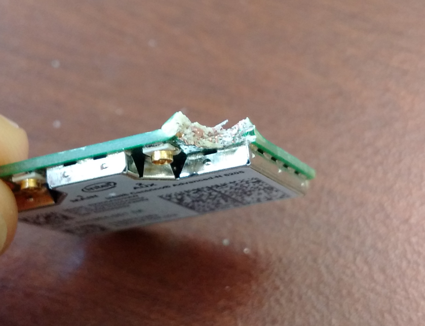

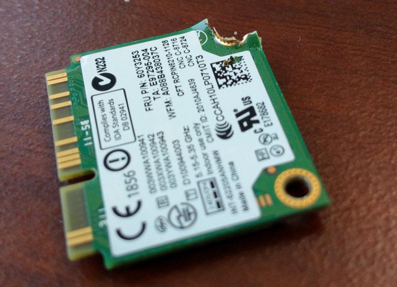

Thanks so much for everyone's help here, I had to break my wifi card to remove it (screw was stripped from previous repair/installation/etc..) and luckily I had my old Lenovo card to put it back in there.

I am not proud but I had no choice:
https://i.gyazo.com/0d291f04ae541ab31c6 ... 482bd9.jpg
https://i.gyazo.com/a8659793d21890c1b10 ... 261e2a.png
Thank god Intel for making it perforated. It made it easy to just snip it. The Thinkpad card does not have the same perforation so it would have been much more difficult to cut it.
