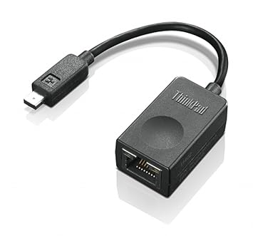

But you can get a special extension cable 4X90F84315
as further detailed here: http://shop.lenovo.com/ae/en/itemdetail ... 9AD7C986A5

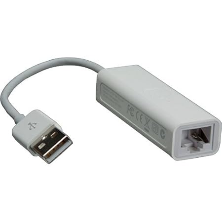

Apparently you should NOT buy any generic USB-ethernet adapter, but instead get one from (oh dare I say it...) Apple (P/N MB442Z/A)

USB2.0 by specification cannot reach Gigabit speeds. USB3.0 can and such adapters exist.
The other extension cable seems to be a proprietary X1 Carbon adapter, and will indeed deliver Gigabit Ethernet via the built-in Intel LAN.

I will have in mind that extension cable, but I feel it like just another thing to carry and eventually to get it lost somewhere :)
