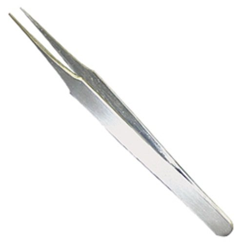

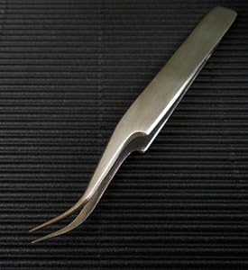

Needlepoint tweezers. Get both straight and angled/curved ones, bonus points for those that have teeth.

Thank you Ray, that is some good advice there!
