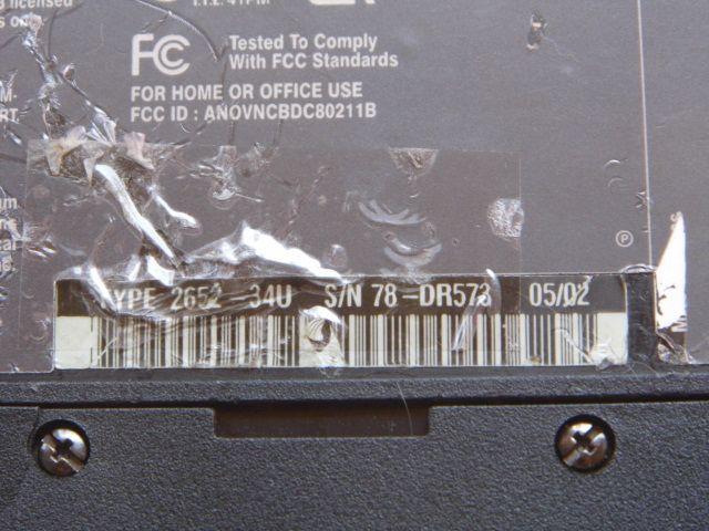

What's the full model number found on the same sticker that holds the serial number and the production date on the bottom of the laptop? Should look something like 2652-P3U or so.Knowing this info would help us help you better.aptivaboy wrote:Hi all,

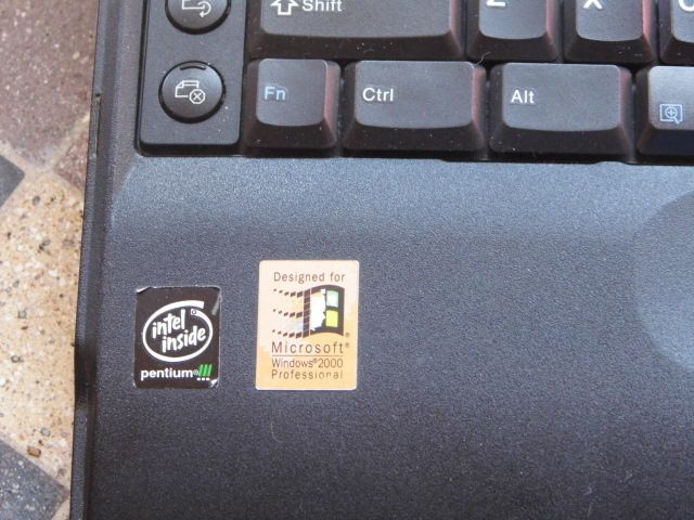

Good call on the model. It turns out that it is an A30. I guess the seller didn't know either since he listed it as an A31. No worries, I'm happy either way.
Its a 2652-34U.
http://i231.photobucket.com/albums/ee11 ... 43uucc.jpg
http://i231.photobucket.com/albums/ee11 ... 4fn8q1.jpg
I'm very concerned about the charger issue. The one I bought was listed a genuine IBM charger but was instead a cheap aftermarket one was delivered. The seller didn't care when I complained. When I first plugged it in, it short circuited half of my condo. Thankfully, I have GFI switches and just reset the outlets and I was back in business. Ebay was no help.
Bob

An interesting system, should have a SXGA+ (1400x1050) LCD...aptivaboy wrote:Good call on the model. It turns out that it is an A30. I guess the seller didn't know either since he listed it as an A31. No worries, I'm happy either way.
Its a 2652-34U.
Code: Select all
PIII-M 1.0GHz (512KB), 128MB RAM, 30.0GB HDD, 15.0 SXGA+(1400x1050) TFT LCD, 8x-2.3x DVD, Modem (CDC), Ethernet (CDC), TV out, Li-Ion battery, Win2000
You should be able to find a genuine one here on the forum for $10-12 or thereabouts...I'm very concerned about the charger issue.
You'll need to max the RAM to 1GB in order to run XP anywhere close to properly. A 7200rpm HDD - or a Samsung HM160HC which is 5400rpm but faster than most 7200rpm IDE drives - would be in order.

Appears that your A31 (or actually A30 rather) might have been a FrankenPad of sorts, assembled from random parts? (kinda like my A22p IPS and R52 UXGA)

Well yes it is a A30 if it has Pentium III Tualatin - M instead of Pentium 4. Their actual speed is actually similar but PIII runs cooler and P4 supports SSE2 which is required on some modern apps. Either way take care of your GPU and make sure either do not put GPU intensive stuff or turn your main fan to fan 7 or 64. Windows XP works just fine but if you max out the RAM Windows 7 also works fine with a Radeon 9000 driver installed for 7000 or 7500aptivaboy wrote:Hi all,
