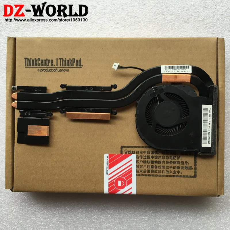

Does such a fan need any thermal paste? I'm absolutely sure they didn't add any paste in there. The guy just put in the fan and left.
For reference, the fan looks like this:
https://ae01.alicdn.com/kf/HTB1rIcxKVXX ... -b-Fan.jpg

Exactly as I suspected!
Yup, the fan MUST have thermal paste.
You can do that yourself, if you are handy with a screwdriver.
Get some decent thermal paste first.
Although Arctic Silver 5 (AS5) is still popular and a very good paste, there are better ones available from the likes of Prolimatech and Thermal Grizzly.
See here: http://overclocking.guide/thermal-paste ... gen-ln2/6/
9) use e.g. Isopropyl Alcohol (91%) and a paper tissue or small cloth to clean off the old gunk from CPU and cooler.
10) apply thermal paste as instructed here: http://www.arcticsilver.com/pdf/appmeth ... e_v1.1.pdf
11) do the reverse from the above web-instructions
Or get the HMM here with illustrated instructions: https://download.lenovo.com/pccbbs/mobi ... k04862.pdf

My additions:Found on the web wrote:How to replace cooling fan on Lenovo ThinkPad T460S
1. Shut down your Lenovo ThinkPad T460S laptop. Unlock and remove the battery.
2. Remove all twelve 6 mm screws from the back of the laptop using a screwdriver.
3. Gently pull the back cover off the laptop. It should come off easily.
4. Disconnect the battery connector from the motherboard.
5. Remove the three screws that securing the fan with a screwdriver.
6. Unplug the fan cable from the motherboard.
7. Remove the black and white antenna cables from the wireless card.
8. Now you can remove the cooling fan and replace it with a new fan for your Lenovo ThinkPad T460S.
