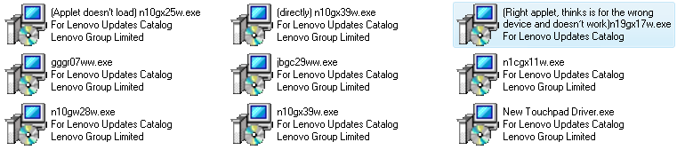

Thanks. I just reinstalled the one for the T450 direct from Lenovo https://pcsupport.lenovo.com/us/en/prod ... 0and%20Pen. It still installs the clunkpad driver
What could be causing this? It worked perfectly for a year with the old driver!

Okay, I've now tried nine (9) different drivers. Most of them claim to be for a trackpad but are actually for the clunkpad when I install them. The original one I used has a control panel applet that doesn't load and works as well as the clunkpad drivers now. I found one that I know works with this model, and the control panel applet loads and shows that. HOWEVER, it doesn't recognize the touchpad at all! This is beyond frustrating. Here's a screenshot of all the different drivers I've tried. Maybe I missed one? I also tried using Lenovo's update tool and service bridge tool directly to get more drivers from there. No dice.

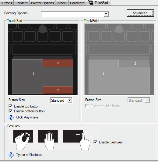

I retried the fix the involves modifying the driver inf. The correct form of the driver installed!… but I was still unable to activate the trackpoint from the applet. The trackpoint still works, even being "deactivated," but it likes to randomly jump around the screen at times; I guess it's not properly calibrated. I'm also unable to use the scrolling feature with the middle button. I guess that's why it always defaulted to the clunkpad version of the driver...
Any idea what could be causing this? It shouldn't be a keyboard issue, since I got one that passed Lenovo certification and has the correct FRU printed on it (04Y2348: US English Chicony - Primary). Of course, while it shouldn't be a keyboard issue, it may still be... The trackpoint still works on the old keyboard, but most of the keys have finally died on it so I can't go back. I'm about ready to just put the original clunkpad back in. It can't be more of a headache than this... Any other ideas on software fixes I could try first?
