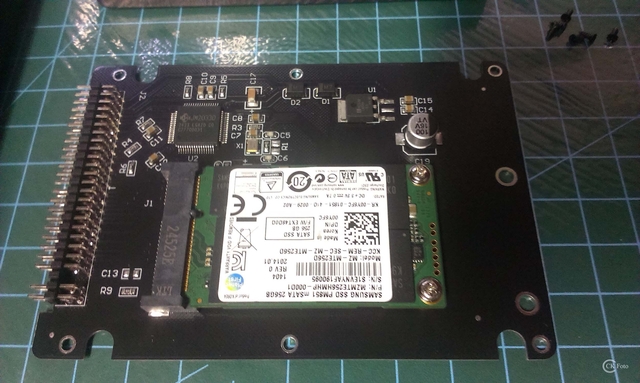

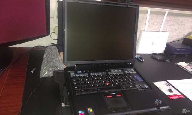

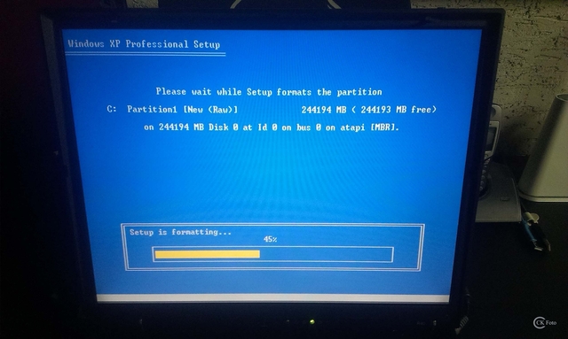

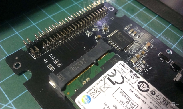

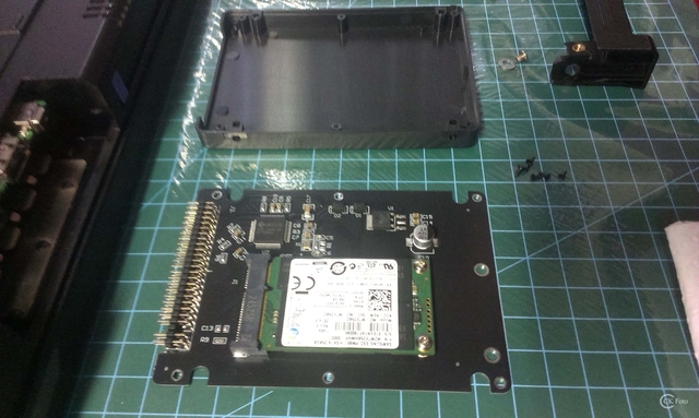

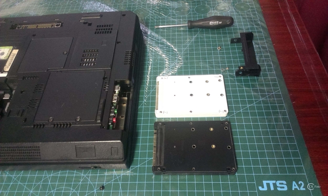

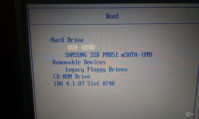

some news after long time to update the topic. The small project with IBM R40 continues. On AE I have ordered one more IDE to mSATA Adapter Case and one Samsung PM851 SSD 256GB. The plan is to use both SSD, one with Windows 7 and other with Windows XP Pro SP3 that I recently have installed successfully. Because is not easy to swap the SSDs, the other Case seams to be practical here. My old CD ith the Windows XP was not dead, I used Lenovo X300 and his CD/DVD drive have read the CD finally. I made ISO file and now I have the good old Windows XP Pro back. With Rufus v.2.18 I prepared one 16GB SandDisk USB and everything went fine with the Installation. I must admit I enjoy to see the legendary XP OS again. I newer used so large SSD, in most cases the 128GB is just fine for me, but here I want to Install some Automotive Programs on XP and they are quite large, so the big one must here. Few pictures from all that I have recently done.
IBM R40 (2722-BDG) - 06/2004
• IDE to mSATA SSD Adapter Case x 2
• Thinklife ST600 mSATA SSD 128GB - (Windows 7 Ultimate x86)
• Samsung PM851 mSATA SSD 256GB - (Windows XP Pro SP3 x86)

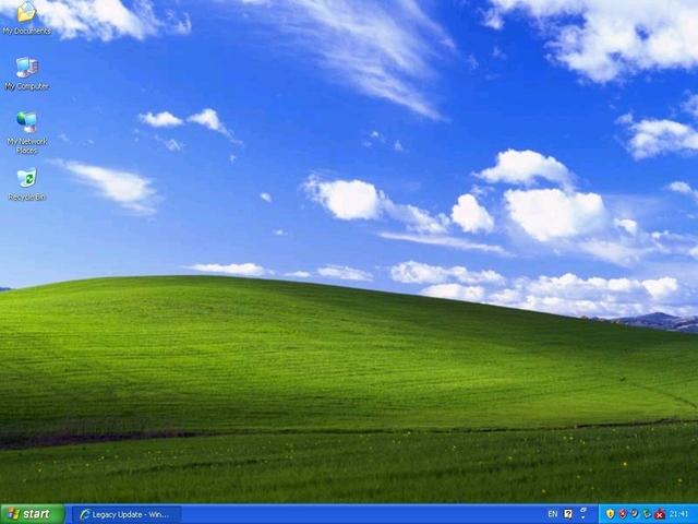

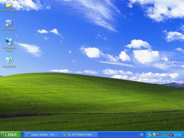

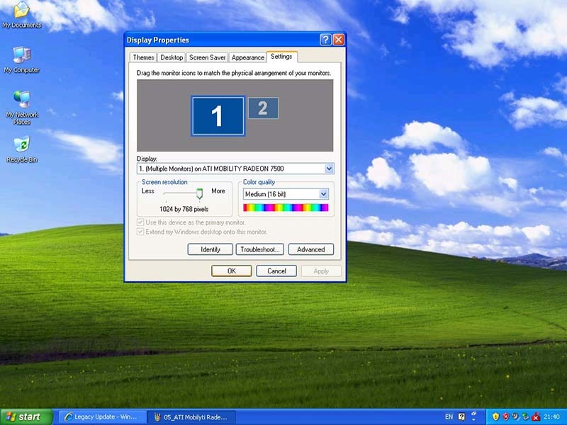

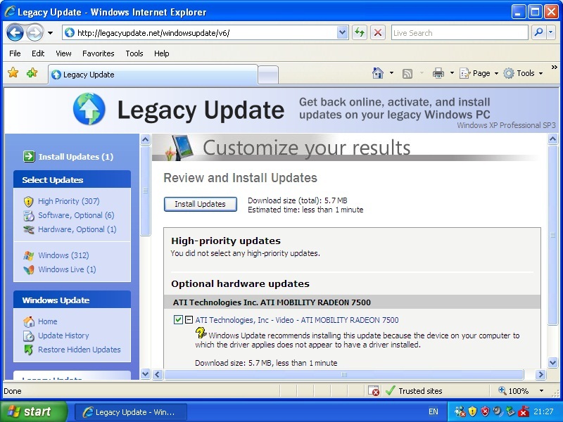

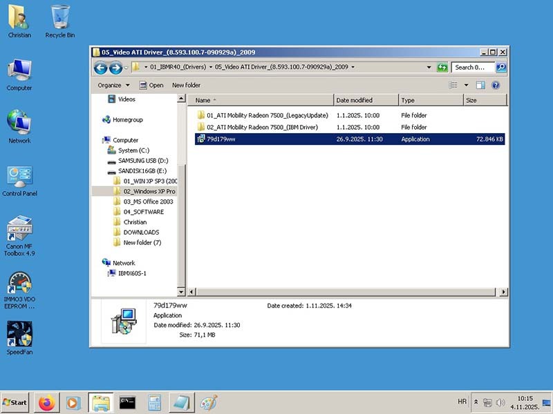

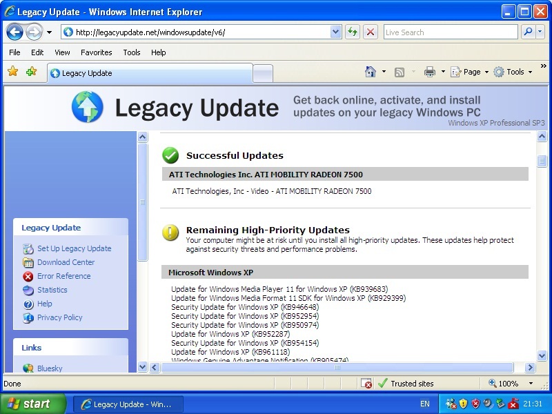

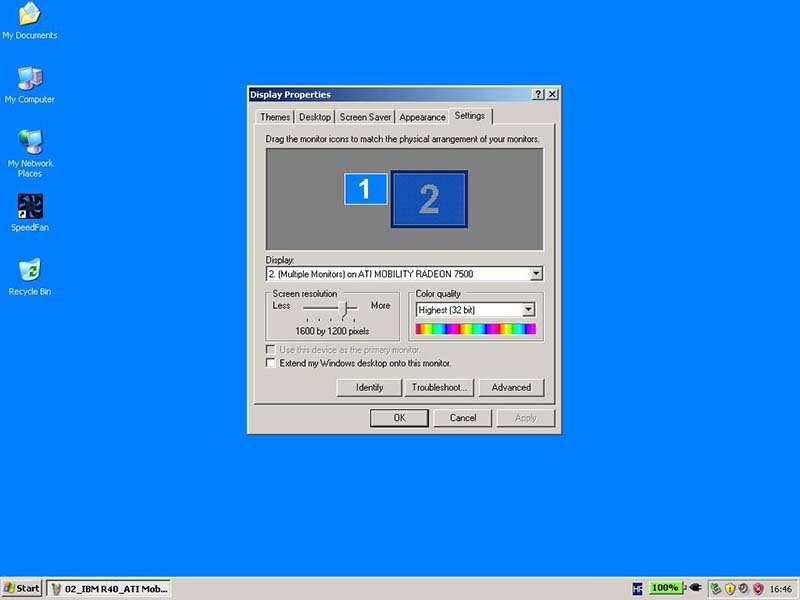

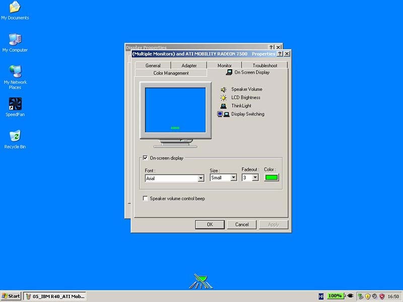

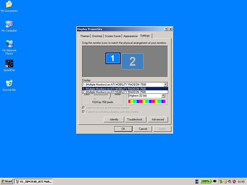

Question for IBM R40 owners or someone who knows. I need some help here with IBM R40 and If anyone has time I would be grateful. On Win XP Pro SP3 I was looking forward to finally install the ATI Mobility Radeon 7500 driver that I downloaded, but the installation failed and I get massage that some driver is missing. With Legacy Update 1.12.1 I easily installed some drivers, all others updates and there was the driver for ATI Radeon 7500 so I used them, so far so good and I get LCD 1024x768p (4:3). I'm not sure what this Graphic Card and LCD supports. I have read that the IBM R40 with 15" LCD was coming in 1024x768 (XGA) and 1400x1050 (SXGA+) TFT LCD. Can somebody confirm me this information, how to check what I have and how to install the ATI driver correctly?
• ATI Mobility Radeon 7500
- Lenovo driver: 79d179ww (2009) - 71,1MB
• ThinkPad R series - (Specifications)

#71 Post by norrinraddhr » Wed Nov 05, 2025 2:30 pm

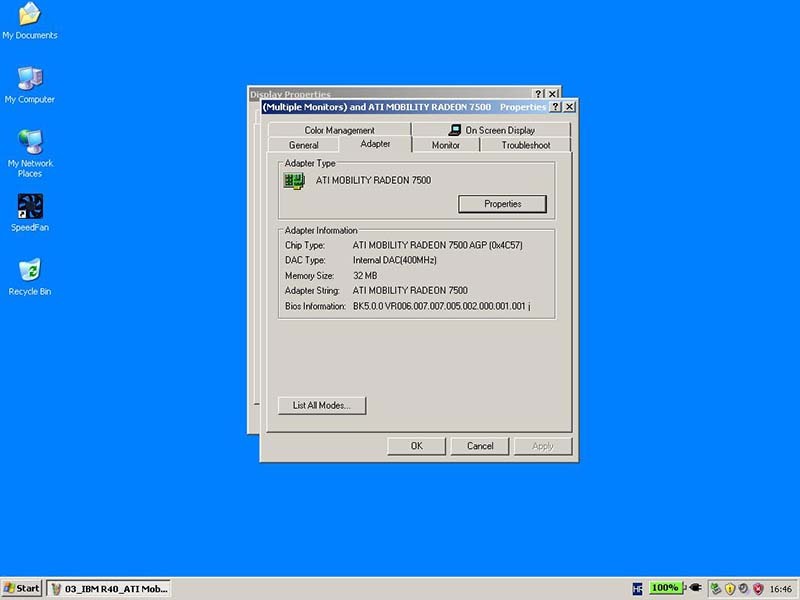

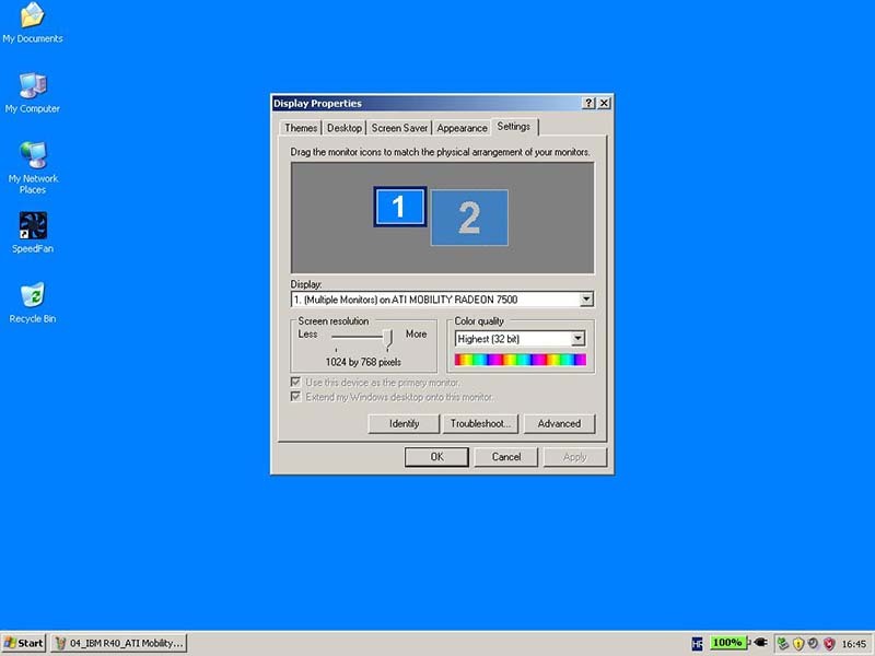

I find some information about Graphic Card and made some Screenshots. The Card has 32MB and it could be possible that he supports (1400x1050) resolution. First I was skeptic, now I don't know, maybe there is hope. :) The only problem is to find how to install the Video driver. I Have Lenovo T60p and there was similar problem, and I installed the video driver manually. I remember that the driver after is started was unpacked and I find him in C:/ Drivers/ WIN folder with all other drivers, find the right SetUp Launcher file and I installed the Video driver. Here I tried the same way but again driver is missing. If anyone had some advice or know where is the right file for installation please share the info here, thanks.
• IBM R40 Wiki
• One of the following video controllers:
- ATI Mobility Radeon 7000 with 16MB
- ATI Mobility Radeon 7500 with 16 or 32MB
• One of the following displays:
13.3" TFT display with 1024x768 resolution
14.1" TFT display with 1024x768 resolution
15.0" TFT display with 1024x768 resolution
15.0" TFT display with 1400x1050 resolution

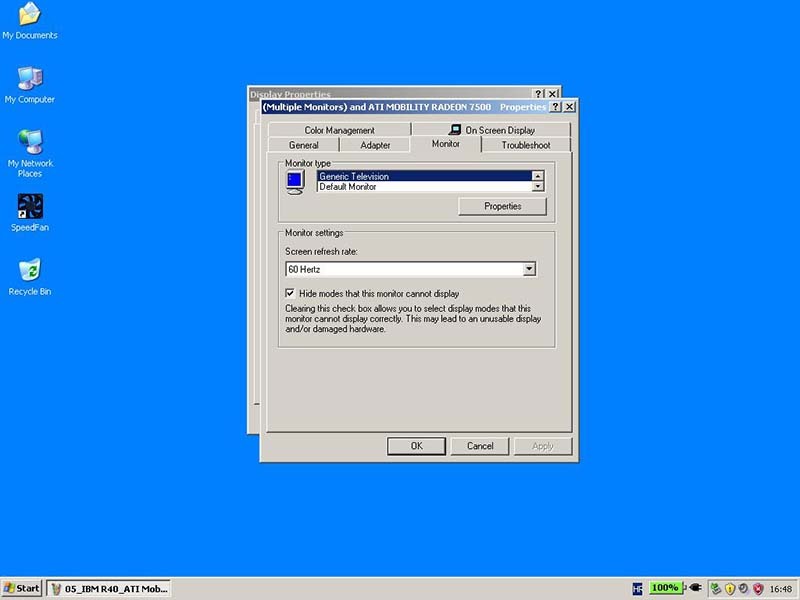

#72 Post by RealBlackStuff » Thu Nov 06, 2025 2:22 am
I just reread this post from the start.
In all these years you have never mentioned what exact LCD you have in your machine.
And you keep going on about graphics-drivers without even knowing this!
Use e.g. HWINFO to get the hardware ID for the LCD, then enter the ID here: https://www.panelook.com/ for details.
Or open up the lid and see what is printed on the back of the LCD.

#73 Post by norrinraddhr » Thu Nov 06, 2025 5:55 am
Because the priority was to make him to work again, all others was secondary and it was a gift, so I had only basically information about this R model what I found on internet. My second excuse is that I only have time for this hobby in Winter, so the time is limited resource here. 8)
The LCD bezel has small crack on left side but holding for now and there is some damage on bottom of LCD bezel, so I'm not sure if I want to disassemble the LCD to get the part number and make more damage as already have. I than this before on IBM X60s, have buying a new LCD and swap this used good one in another IBM X60s with broken LCD but I rather wouldn't do that here because the all LCD bezel is fragile.
I will try with HWiNFO what you suggested, seams to be the easiest way to find the part number of the LCD, if not I will leave this as it is. You can't always get what you want, can only try. :) Thanks RBS.
