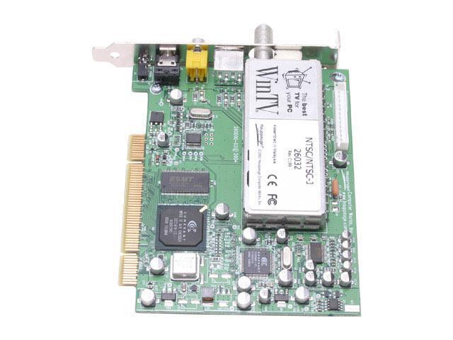

This is the exact card I have in my Dock II. It's a standard size/height PCI card (not the half-height).

http://www.newegg.com/Product/Product.a ... 6815116625
http://images10.newegg.com/productimage ... 625-04.JPG
Also, if you purchase the regular PVR-150 (NOT the MCE Edition), it comes with Hauppauges own WinTV software and an IR remote control, which allows you to watch & record TV using Hauppauges software (so you don't need Media Center 2005 installed).
Regarding size, both the PVR-350 and PVR-500 were too long to fit in the Dock II PCI slot (I've got a PVR-500 in my main media center & it just wouldn't fit). I'm not sure if the PVR-250 would fit, but it might, since it's also a single tuner card like the PVR-150. However, the PVR-150 is actually a newer design than the PVR-250 and the 150 uses the newer Connexant "Blackbird" encoder.
