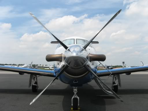

Then there are the aircraft that are altitude limited due to arcane FAA rules. My son's PC-12 is altitude limited to FL300 due to the fact that the FAA mandates that oxygen masks must descend from the overhead in the case of a loss of cabin pressure above FL300. The masks in a PC-12 come out of the side of the cabin and therefore don't meet the FAA requirement.
Regards,
