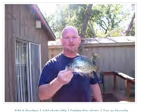

Is there any way you can post an example of what the distortion looks like? If you can't get a good photograph of it with your camera, you should be able to grab a screen capture by pressing the PrtSc button and then open Paint and Paste the image. Crop it down to just the picture/photos, upload it to a hosting service and post a link to it. (If that's not possible, you can e-mail it me and I'll put it up on my site; contact me via PM.) Maybe somebody can identify what the problem is. That's assuming of course that the screen capture HAS the distortion in the first place!
Ray, thanks for the quick response...here is the link. Looks like the distortion is there! At first glance, one might think that the sun has distorted the pictures. However, this is not the case. notice the blurred image at the bottom right side of the pic as well as the side of my lake house...the fish was very dead and not moving as well..
One interesting point to mention...normal graphics are fine (browser graphics, icons etc...)..the problem seems to only be with pictures...
http://i144.photobucket.com/albums/r177 ... y_fish.jpg

From the looks of it, I would say there's a problem with your computer's handling of the JPG encoding algorithm. It appears that some parts of the image have been grossly over-compressed. Check to see how much compression has been used in whatever picture processing program you are using. Generally located in a Preferences tab.
If this distortion ONLY affects the pictures or images that YOU have personally posted, then that should fix the problem. It's also possible that your picture hosting service (photobucket.com) has a setting somewhere that you can adjust. Basically, the more you compress a picture, the smaller the file gets at the expensive of clarity of the image.

Last night, I ran a few "tests" to see if this was the problem...to my dismay, it was not. You see, this also happens when she goes to "google images" and selects a random picture that comes up in a search. These images are also distorted (pictures that people have taken, not icons or computer generated images). These images can also be .jpg, .bmp, etc...
This is really strange. My next step is to start uninstalling applications that are not "mission critical", one by one to see if that fixes the problem. If not, my only other option will be to blow away the laptop and start over with a fresh OS install and then all her applications.
If anyone has any other suggestions, PLEASE let me know!
