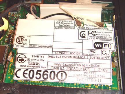

RealBlackStuff had asked what card I put in and perhaps the best start would be to show a couple of pictures:
img]http://i4.photobucket.com/albums/y106/d ... ard-00.jpg[/img]
img]http://i4.photobucket.com/albums/y106/d ... ard-01.jpg[/img]
Maybe this will give someone a clue. Tell me if I need to pull the card and look on the reverse side.

Sorry to hear about your loss, my condolences.
The Ambit website claims their t60h786 should also work in IBM T40/T41/T23/T30.
There are some drivers available here:
http://members.driverguide.com/driver/d ... rid=730097
There's a post on this forum about your card:
http://forum.thinkpads.com/viewtopic.php?t=42856
Their solution was to ENable wireless in the BIOS, is yours enabled?
I don't know anything about flashing those cards. If needed, only use official software from the official website (if you can find it).
Check that both antennae make proper contact, swap them to see if there is any improvement.
Good luck with this lot.
PS: your card was made by: PCD Global, it is 802.11b/g and has the Atheros chip AR5004G, so should not even need no-1802!

In the ThinkWIKI is a post where people cut a 'leg' off the chip, that could solve your problem.
But I think it is better to return it to the seller and get your money back.
Then look for yet another card.
Check signatures of forum-members with a T30, quite a few have their wifi-card mentioned in it. Get the one that you find most of.
I like my own card, even with the 01c9 error, but it is hard to find, and maybe even succeeded by a newer model now.
