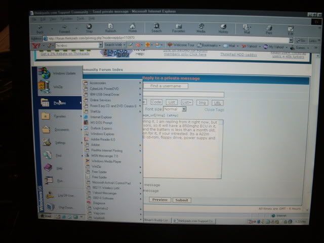

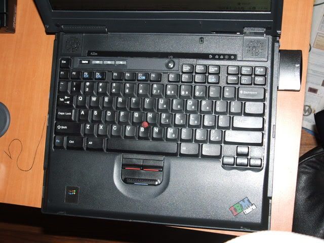

I am going to be keeping the T21, as soon as I figure out the processor thing. What would be a good price for the A22m, it has new battery, old bad battery, win98 SE, 850Mhz, AC adaptor, Wi-Fi g, DVD-cdrom 20gig HD. I also have a docking station.

At the risk of offending, I'll bite on this. :lol: I'll start by saying that the unfortunate thing about machines like this that they have a greater value to the owner than someone buying it. Because, by and large they are a commodity that is rapidly running out of PERCEIVED lifespan. Based on what I've seen both here and one ebay (I've looked a lot since I have parts for an A22m, but need a good MB), I'd say that the value would be somewhere North of $150, but you'd probably struggle to get close to $200. That's because, faster machines like the A30 and T23 are falling into that price range.
You might be able to feel a little better about it by selling off a couple of things seperately or keeping them such as the dock (which should work with your T) or the better battery and selling the machine with the bad one. Typically, a bad battery will not drop the price as much as a good one will bring when sold seperately. Hope that make sense. Good luck on this.
