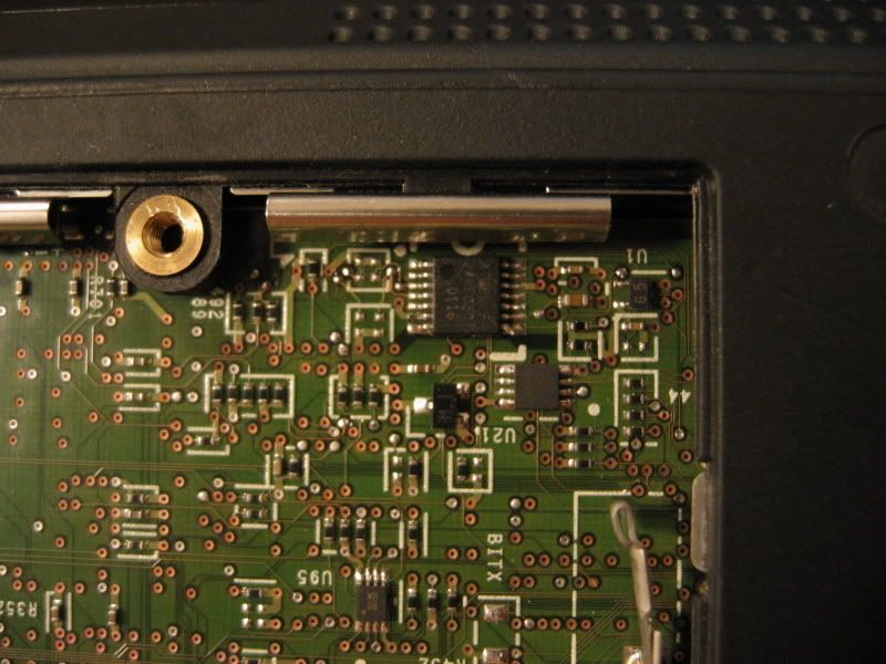

15W soldering iron, less than one second of indirect touch [let the wire or solder carry the heat].
one of the tries i got the coil back on, but it still wouldn't start.
http://i55.photobucket.com/albums/g142/ ... G_1776.jpg
^thats the job i had to do to get the SVP so i could use my TP again. while the one lead doesn't look stable, its fine, and my baby has no problems whatsoever.
the one coil was just not working for me.
btw, silver bearing solder is a must, not any other type. 15W soldering iron is the most you want for this as well.
i've thought about just using hot air, but i didn't trust it too much.
