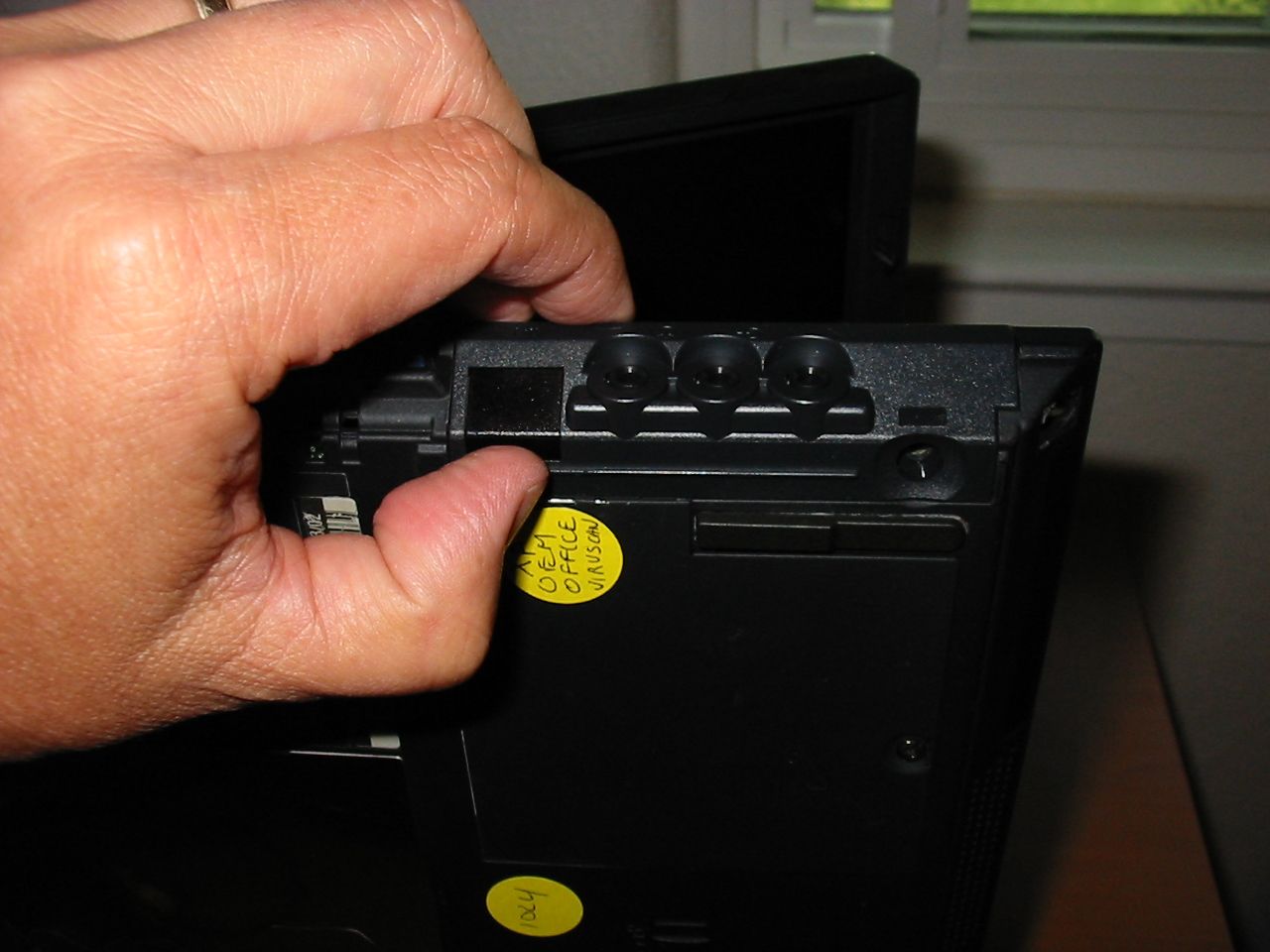

#6 Post by rkawakami » Mon Oct 29, 2007 2:44 pm
There's a raised line in the plastic that extends from the screw hole to the opposite end of the hard drive cover. You are supposed to use your fingernails to pull the drive out. For me, I've found that it's easier to use both thumbs to lift up on the cover. If it's really hard to remove, slide a flat-bladed screwdriver between the cover and the base and then twist. If somebody used the wrong screws on the caddy, the drive will not slide out all that easily.
http://www.kawakami-ca.com/images/t2x_hd_removal.jpg
And yes, the lid of the system needs to be open!

#7 Post by evilfabio » Mon Oct 29, 2007 4:28 pm
After watching the movie, I discovered my problem. The little plastic thingie (I guess the hard drive cover) comes off, leaving the hard drive inside. In the movie, the cover and hard drive slid out as one. I'll experiment and see if I can get it to do that instead of coming off the hd.

#8 Post by carbon_unit » Mon Oct 29, 2007 7:14 pm
It is supposed to hook over the heads of the screws in the hard drive. You can use a small screwdriver in the hard drive retaining screw hole to push the drive out.
