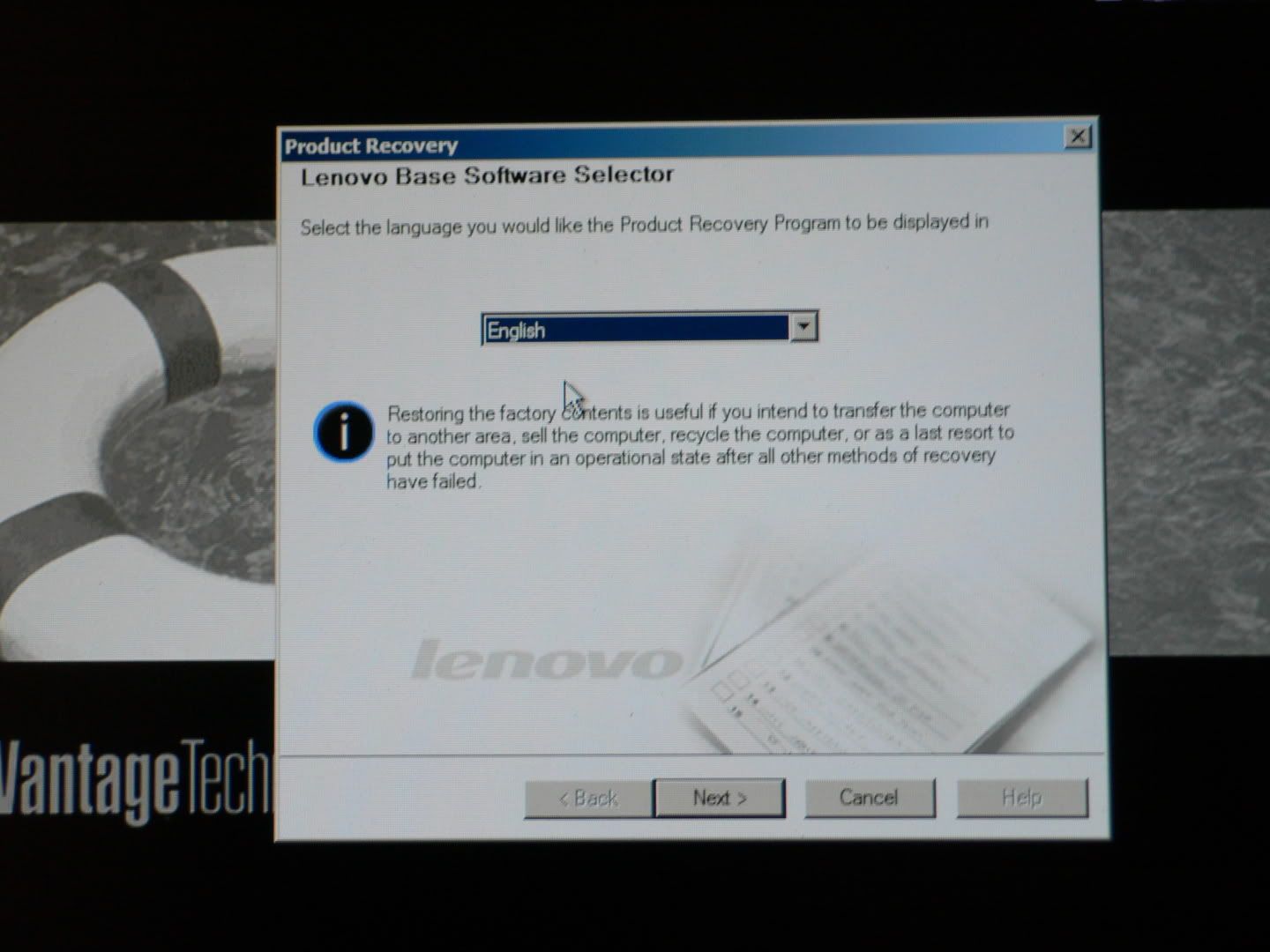

Step 4. Select your language and click Next.

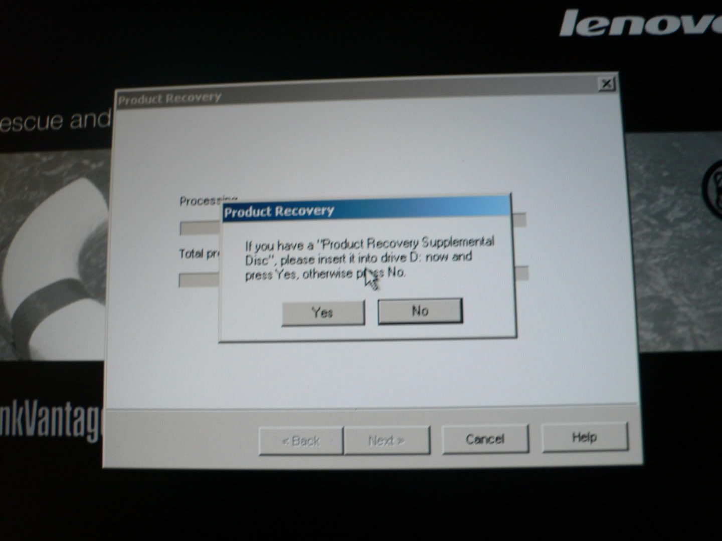

Step 8. If you have a Supplemental Recovery Disc, insert it when prompted and click Yes. If you do not have a Supplemental Recovery Disc, click No.
Note: Not all recovery disc sets come with a Supplemental Recovery Disc. If there is a Supplemental Recovery Disc, it will be clearly marked as such.

h (If you have a Supplemental disk then insert it 1st then press "Yes" otherwise "No").
If you pressed No, then do not take out the disk the process is going to access the required files from it again and will halt for a while, no need to panic, give it 10-15 mins.

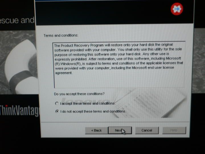

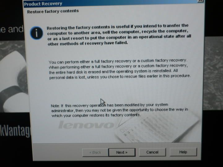

-Things looks differently (GUI mainly) for Windows XP disks made under Rescue and Recovery 4.1 (the latest suite available today):
A. Disk 1 (Rescue and Recovery) prompts following menus:
1
2 (Press full restore in case that's what you would like to do).
3
4
5
6
7
8
9
10
11
12.
B. Disk 1 will prompt (when it's done ofcourse):
13
Rest of the process is identical to Vista disks explained above, pretty much self explanatory; you insert the disks and they recover/restore your machine.
