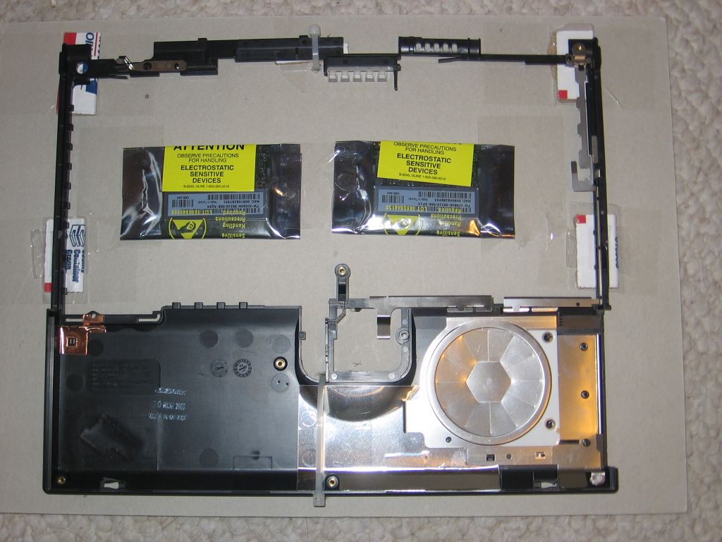

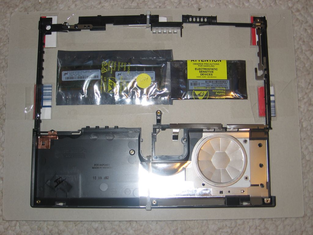

Here's a couple of pictures to show you how I like sending stuff:
http://www.kawakami-ca.com/images/img_7159s.jpg
http://www.kawakami-ca.com/images/img_7160s.jpg
Keyboard bezels were mounted to very stiff and thick pressboard and secured with tie-wraps. Areas which did not rest flatly on the board were shimmed with folded cardboard (middle left and right, top corners). Memory modules and wireless cards were wrapped in antistatic bags and taped to the board so they wouldn't go flying around the box. Both of these boards were then wrapped in bubble pack and put into a box large enough to have at least two inches of space from the bottom and top. Package was shipped from US to Holland, with an unexpected side trip to Thailand

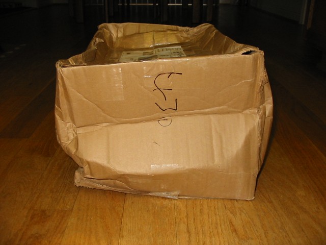

and everything was reported to have been received well. Yes, I probably over-engineer my packaging but when you have received stuff like this:
http://www.kawakami-ca.com/images/4nu_1.jpg
I don't think I'm overdoing it
