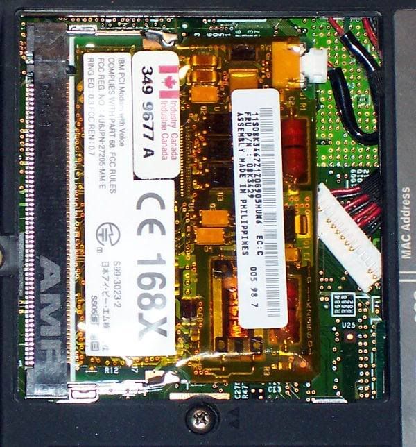

Thanks for the help guys got the audio display working, but now that I open up the Mini-PCI modem slot under the laptop. There are 2 plugs on the card one small 2 pin plug & a larger multi pin plug that is disconnected. Should it be disconnected? Is it modem or Ethernet card only, one connected at a time? Or should I just connect them both & maybe that will fix the problem in Device manager.
But I don’t see how to pop out the card, will the card slide out or is it a setup like the Ram that pops up the card after releasing some pins?

Some models of the T20 can come with a combination ethernet and modem card. Others will have just the modem. The modem connector is the two pin, 3mm wide one near the corner of the MiniPCI bay. The ethernet connector is about 18mm (0.75") wide and is closer to the center of the bay. If your card has the matching white connector that is nearly an inch wide, then your ethernet is disconnected.
The card is removed exactly like the memory modules; there's two metal arms which need to be pulled slightly "outward" from the center of the module and then it (should) swing upwards. The short length of ribbon cable for the modem connector and the larger ethernet connector may get in the way of the card lifting up.

Thanks rkawakami there was a mettle cover on the modem that was confusing me. But now that I removed the plate & lifted the modem I see there’s no place for the unconnected plug to connect to. So I’m guessing this is only a modem & not combo card, which makes me wonder what is that plug for? And could that be the reason I have a problem in Device Manager?

catscam wrote:Thanks rkawakami there was a mettle cover on the modem that was confusing me.
Ah, yes, the MiniPCI lockdown plate. Forgot about that...
catscam wrote:So I’m guessing this is only a modem & not combo card, which makes me wonder what is that plug for? And could that be the reason I have a problem in Device Manager?
The picture appears to show a modem-only MiniPCI card. The connector inside the laptop is for the ethernet port. goofyGAguy has referenced one of the combo cards which will have the matching ethernet jack for that plug. You may need specific drivers for that eBay card as it doesn't look like the ones I normally see inside T20-T22 systems.
As far as causing the Device Manager error, I can't be sure. If your previous OS (Win98) did not show this then I don't know why XP would. To add a little bit more information, what is the TYPE number of your system? Located on a bar code label on the bottom of the system, it should start with 2647- or 2648-. The last three characters will say what the initial configuration of the system was when it left the factory. You can plug the TYPE number into this page:
