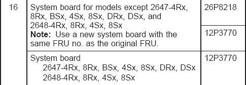

My mobo is dead! Is a Fru 26P8218.Can a use 12P3770 ??? ....what is the diffret between them
- Posts: 10052
I am not exactly sure of the difference but this information comes from the Hardware Maintenance Manual:
Those type numbers that are listed seem to be 1.13Ghz XGA systems. As much as I have done with the T23, I do not know why these systems are special enough to earn this warning.
Re: 26P8218 vs 12P3770 *PIC warning*
I know this is an old thread. I just had the same question to answer in order to replace a dead T23 Mobo.
I found this document which explains the issue:
There was a change in the chipset, so if you replace your board with a different FRU on an existing Windows installation, you might have some problems because Windows has to detect all the system components again.
So, if you install a new OS anyway, it does not make a difference which FRU you take.

Thanks for posting that information! Here's the relevant table from the Lenovo Support page:
Furthermore, the "B1" planar can be recognized by opening the dock port covers on the bottom of the system and seeing if there's a black triangular mark near the back right corner of the connector. The rule is: if you have a B1 planar, then replace it with an FRU 12P3770, otherwise, use the FRU 26P8218. I'll look through my T23 systems and if I find a B1, I'll post a photo of that area
Code: Select all
If you have this P/N You should order this P/N
26P7997 26P8218
26P8218 26P8218
12P3770 12P3770 Ray Kawakami
