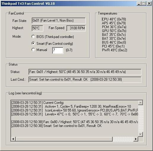

Okay here are the results of Fan Control V0.18
Fan State: Fan Level 7, Non Bios
Highest: 78°C
Fan Speed: 4017
CPU 65°C
APS 53°C
PCM 41°C
GPU 79°C
BAT 37°C
BAT 35°C
BUS 52°C
PCI 54°C
PWR 50°C
Could someone help me with these values?
Tom[/img]

65*c at idle is a bit high, and would explain why the fan is running full speed all the time. First, I am willing to bet my next paycheck that your old T43 fan was running all the time too, but at a much lower speed so you didn't really notice it. Personally I'd reseat the fan myself with a paper thin coat of some Arctic Silver thermal compound and not call service again.
The tech guy did put some extra thermal compound on it since he was the same who exchanged the first fan 2 weeks ago.
The GPU temp is around 80°C - is that normal?

T43p [2668G2G] | 2.13GHz | WXPP | 1GB RAM | 60GB (7200rpm) | 14.1"(1400x1050) | Mobility FireGL V3200 | Intel 802.11a/b/g | Bluetooth | Fingerprint Reader | Ultrabay Multiburner | 9 Cell LiIon | 6 Cell LiIon | Ultrabay Li-Polymer 1.5 Ah | MiniDock II
Extra (as in thicker) thermal compound is bad for heat transfer. Think paper thin layer, almost translucent. Buy some arctic silver 5, print out the application instructions, and hand them to the repair guy if you have to ...
The GPU temp is high too if the machine is at idle ...

Okay I guess he was careful when adding the thermal compound, but I am sure it was no ArticSilver5 ...
What made me suspicious was that he said that he could exchange the mainboard as well but if that does not help he would not know what to do ...
Question: If nothing helps do I have to live with that annoying fan or do I have a right during the 36 months that IBM get that fixed or offers me a deal with a new model or something like that?

Your problem is clearly an umproperly replaced heatsink fan. Your GPU is not making the right contact with the fan, and the CPU is not either that good... The fan is activated at medium-high speeds because the system sees those temps. Maybe this is because the thermal compound is not correctly applied (too much/too few), or because the sink is bent a bit, or because the screws are not fastened well, or you have removed the 'pink' thermal material sheet in the GPU part and not filling the gap,... whatever it is you either look for someone who can do it under warrantee (lenovo), or fix it yourself (not that difficult), but GPU temp should be around 60C when at idle and CPU not higher than that either (much lower if power management is properly configured for the processor).

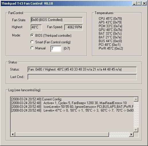

Hi all,
So the story continues ... tech guy was here yesterday and exchanged the system board after replacing the fan unit 2 times a few weeks ago.
Started the machine and ... same story ... fan runs at 4000 rpm and drives me crazy.
Overall the system temps are slightly lower:
NEW FAN/
OLD SYSTEM BOARD.........NEW FAN & SYTEM BOARD
Fan Speed:..........4017 rpm...........4028rpm
CPU..........65°C..........57°C
APS..........53°C..........51°C
PCM..........41°C..........39°C
GPU..........79°C..........66°C
BAT..........37°C..........36°C
BAT..........35°C..........25°C
BUS..........52°C..........50°C
PCI..........54°C..........55°C
PWR..........50°C..........49°C
All temps while I write this message without running anything else, processor load around 0% to 3%
Okay, so what to do now?

Do these log values and settings look okay:
[22.03.2008 08:03:43] Current Config:
[22.03.2008 08:03:43] Active= 0, Cycle= 5, FanBeep= 1200 30, MaxReadErrors= 10
[22.03.2008 08:03:44] IconLevels= 50 55 60, IgnoreSensors= XXX,YYY,ZZZ
[22.03.2008 08:03:44] Levels= 47°C -> 0, 50°C -> 3, 55°C -> 4, 60°C -> 7, 70°C -> 0x80

I wonder why your fan would run at 4000 rpm while your temps are so low? Did you adjust anything by hand? Mine would not run at all with temprature under 50°C!AdaSch wrote:After 10 hours
CPU LIQUID PrO
GPU AS5
cpu pentium M 780
br
i don't use tpfan. This is std bios settings.
With tp fan
but i found why std fan in t43p is very loud
2 easy mechanical mod and now is silence like in my t40 (no needed to use tpfan)
if You/someone need i can send solution on PM and you rewrite this in clear english for all
br
With tp fan
br

my fan noise goes up and down, now its quiet not and this is the heat:AdaSch wrote:Hi,
With tp fan
br
how you could edit the Mode ? its not editable from my side
also if you can re-write what you did to help us that would be great
