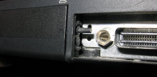

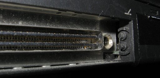

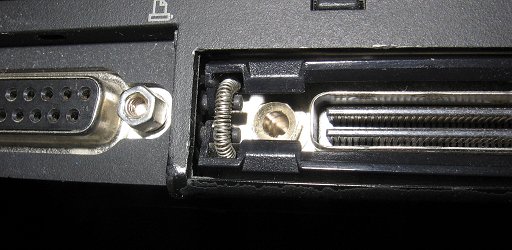

Yes, the two pins on the left side (as viewed from the back, bottom of the system down) are longer than the two on the right. Here's some pictures of a broken and working docking port on two of my 600Xs:
http://www.kawakami-ca.com/ibm_600x/ima ... g_port.jpg
http://www.kawakami-ca.com/ibm_600x/ima ... t_left.jpg
http://www.kawakami-ca.com/ibm_600x/ima ... _right.jpg
I apologize for the dust and dirt but that's what I get for not having the port covers on that system :) .
I believe it is possible to install the docking port covers from the outside. In other words, you do not have to disassemble the system in any way. What seems to work is to put one port cover over the longest pin first, then carefully bend the opposite end until it slides over the short pin. Repeat the same process for the other cover, making sure that the spring goes over the long pins (towards you, not further into the system).
edit: I should clarify that the "broken_docking_port_left" picture shows a missing lower pin, while the "broken_docking_port_right" picture actually isn't broken :) . Both of the pins on the right are intact.

The left pins in my machine both look like the bottom one in "broken_docking_port_left.jpg": completely broken off.
Thank you for the explanation and the pics!
Posts: 10053
#4 Post by rkawakami » Fri Mar 21, 2008 5:19 am
Oh, sorry to hear that :( . I think you are correct when you say that you need a whole new base to replace those broken pins. If by some miracle you have the broken pieces, it might be possible to use "super-glue" to re-attach them. That may require a complete disassembly in order to get them installed.
