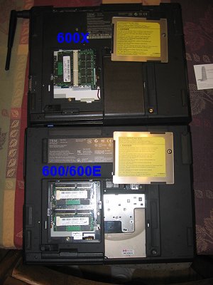

Easier thing to look at might be to check the orientation of the memory sockets. A random selection of a 600, 600E and 600X shows this:
http://www.kawakami-ca.com/images/600E_ ... _slots.jpg
The 600/600E has the modules in separate slots and the long edge parallel to the front of the system. The 600X has a single, dual-slot connector and has the long edge of the module parallel to the side.

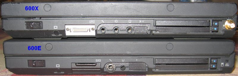

Also, to highlight the differences in the right side:
http://www.kawakami-ca.com/images/600E_ ... t_side.jpg
The position (and number) of audio jacks is different, as is the location of the external floppy connector.
