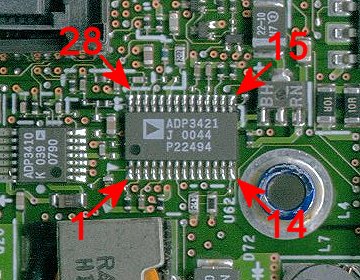

Hi, thanks Ray I've now found it . After reading your reply I had another look with a strong light and magnifying glass !
I assume the pin numbers run 1 - 14 across the top and 15 - 28 along the bottom? Sorry to ask such a daft question but I'm getting paranoid about buggering the thing up - I did see a chip with odd numbers one side and even the other ;-)
thanks again
Posts: 10052
Re: T-Series BoD Fixes List (quotes from other threads)
#14 Post by rkawakami » Wed Jul 18, 2012 10:03 pm
As pictured in the photos on my site, the ADP chip has pin one located next to the black "dot" or depression on the top surface of the packaging. Pins are then ordered down the "left" side to pin 14 (again, as seen in the photo). Numbering then crosses to the "right" side of the package at the "bottom" to 15 and then goes up to pin 28. Thus, pins 1 and 28 are directly across from each other at the "top".
If you are viewing the ADP chip such that you're reading the part number (ADP3421) and the lot and date codes, then pins 1 to 14 are on the "bottom" (going left to right) and pins 28-15 are on "top" (again, going left to right). Pin numbers for this type of package always starts at the lower left (next to the pin one mark) and works the way around the chip in a counter-clockwise direction.
Edit: As they say, a picture is worth a 1,000 words:

Re: T-Series BoD Fixes List (quotes from other threads) *PIC*
#15 Post by aljohn » Thu Jul 19, 2012 4:40 am
Wow! Not such a silly question after all... I'm glad I asked. Thanks again Ray, your help is much appreciated. I now need to check out the smallest of my soldering irons, I suspect I shall need a new one. When I've soldered the chip I'll post the result for anyone else to see.
