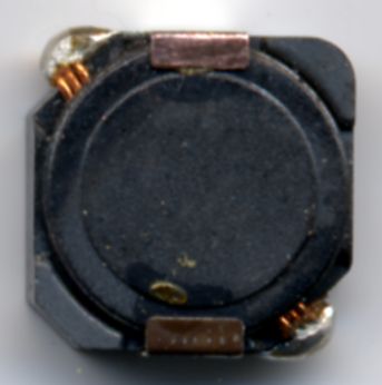

how do I know, if inductors are soldered properly? there is one "thing" directly left beside the gpu (1R7MM492) that looks not correctly installed (it is asloped). what is this? could that be the reason?

Does it look like this: http://www.kawakami-ca.com/images/inductor.jpg
This is the bottom side which mounts to the motherboard. The two copper pads at the top and bottom of the photo is what is supposed to be soldered onto the board. If it is this part, then you should scrape off any grey or black "film" on those pads before you attempt to re-solder it. What seems to work for me is to apply a tiny amount of solder on each pad before you place it down on the matching pads on the motherboard. Use a small-wattage soldering iron (~25W) with the finest tip you can get for it. Heat the side where the metal pad wraps around and apply a small amount of pressure down on top of the part. That should attach one side. Then heat the second pad on the opposite side.

it's still attached on one side, but the shape is exactly the same!
your description is a perfect help for me, I'll try to fix it soon.
should I first take off the inductor conmpletely or leave the one good soldering and just try to fix the second?
ps: do I need special equipment? I have an ordinary, cheap soldering iron for 230V AC, the tip is sharp and on the top less then a mm wide.
- Posts: 10056
I would remove the inductor and clean off the pads since if one side lifted up, the other side may eventually loosen as well. But that's your call. It would be simpler to just re-solder the one side if you can manage to get some new solder underneath the inductor's pad.
No other equipment should be needed other than the solder iron, some solder and a pair of good eyes.
