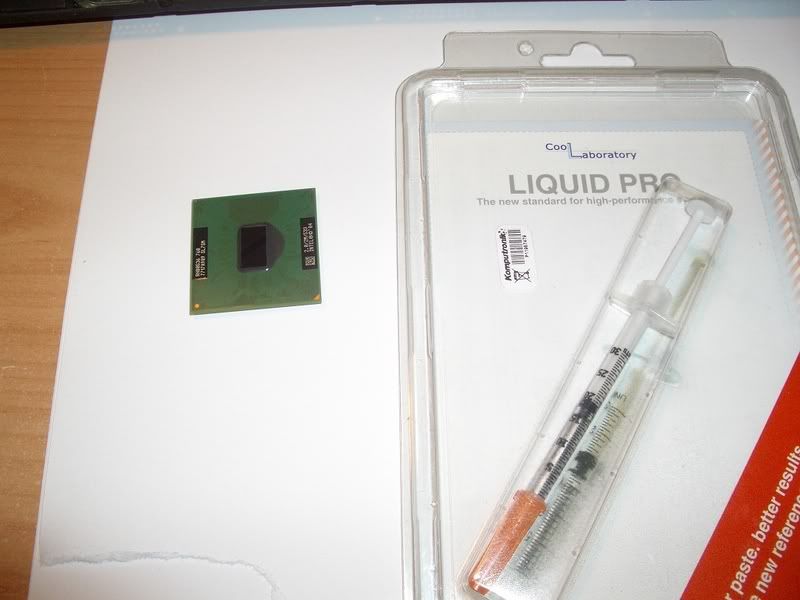

my two t43p are very silent - look on solution
my english is very poor but i tray explain why t43p is loud
automatic translation by google.
a description of why t43p is loud
1 GPU in t43p is different than other models
2 GPU and the CPU does not have an equal amount (CPU is above)
3 stupid engineer with the LENOVO, instead of a different design heatsink devised setting of the thermal GPU between a heatsink
4 A worker, of course, too much preparation required conductive heat
5 heatsink not kept level and is not founded in parallel to the structure of the CPU
5 Radiator is the side GPU
6 engine windmill based on the enclosures
7 casing acts as a resonance box
8 solution - to remove all between heatsink and GPU
9 apply the usual silicone or something similar, but soft
10 radator perfectly sit on the CPU
11 does not touch the engine casing - enjoy the silence, and a lower temperature.
12 I do not recommend AS5, better use liquid cool labolatory pro - the best product
i have many pics from this process
please correct my fatal english
Please, someone to prescribe them to be legible
p.s.
i replace pentium m 750 to 780, but i don't hear diff. still silents
Pentium m 780 is much quicker

#10 Post by AdaSch » Sat May 31, 2008 5:58 pm
think.t23 wrote:AdaSch, thanks for your reply.
It would be nice to see some pictures of this process to get a deeper understanding.
thanks.
http://i53.photobucket.com/albums/g79/a ... 30-duy.jpg
http://i53.photobucket.com/albums/g79/a ... 32-duy.jpg
too much thermal glue
http://i53.photobucket.com/albums/g79/a ... 33-duy.jpg
http://i53.photobucket.com/albums/g79/a ... 35-duy.jpg
true noise generator (stick between chasis and fan)
http://i53.photobucket.com/albums/g79/a ... 36-duy.jpg
http://i53.photobucket.com/albums/g79/a ... 37-duy.jpg
before fan modify
http://i53.photobucket.com/albums/g79/a ... 38-duy.jpg
after fan modify (-0,5mm)
http://i53.photobucket.com/albums/g79/a ... 39-duy.jpg
http://i53.photobucket.com/albums/g79/a ... 40-duy.jpg
http://i53.photobucket.com/albums/g79/a ... 41-duy.jpg
http://i53.photobucket.com/albums/g79/a ... 42-duy.jpg
http://i53.photobucket.com/albums/g79/a ... 45-duy.jpg
http://i53.photobucket.com/albums/g79/a ... 46-duy.jpg
http://i53.photobucket.com/albums/g79/a ... 47-duy.jpg
http://i53.photobucket.com/albums/g79/a ... 48-duy.jpg
http://i53.photobucket.com/albums/g79/a ... 51-duy.jpg
lenovo error, bad contact, bad connstruction of heatsink
http://i53.photobucket.com/albums/g79/a ... 52-duy.jpg
buisness card is too fat!
http://i53.photobucket.com/albums/g79/a ... 53-duy.jpg
regular a4 paper is ok
http://i53.photobucket.com/albums/g79/a ... 54-duy.jpg
lenovo orginal thermal component is too fat without silicone!!!
http://i53.photobucket.com/albums/g79/a ... 55-duy.jpg
and the liquid pro :)
http://i53.photobucket.com/albums/g79/a ... 56-duy.jpg
http://i53.photobucket.com/albums/g79/a ... 57-duy.jpg
http://i53.photobucket.com/albums/g79/a ... 58-duy.jpg
http://i53.photobucket.com/albums/g79/a ... 59-duy.jpg
http://i53.photobucket.com/albums/g79/a ... 60-duy.jpg
http://i53.photobucket.com/albums/g79/a ... 61-duy.jpg
and
results
http://i53.photobucket.com/albums/g79/adasch/TFC.png

#22 Post by David_r » Tue Mar 23, 2010 5:10 am
I additional remove heatspreader from GPU chip and reaply fresh thermal compound.
http://www.spawalniczy.com.pl/1.jpg
http://www.spawalniczy.com.pl/2.jpg
At maximum performance i noticed 72C - cpu and 65C - gpu
(t43p 15'UXGA - 2.13Mhz - ATI v3200)
