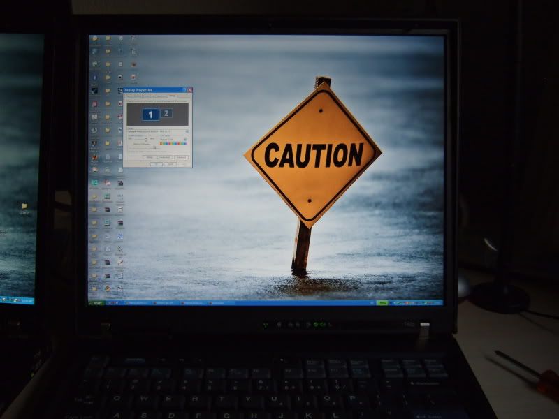

#33 Post by obarriel » Sat Mar 21, 2009 1:09 pm
Well the new panel arrived. Today I have installed it. No issues this time. Everything about installation is a bit tricky not only because the panel is slightly thicker, also because the lcd cable has not exactly the same shape that the T4xp. But it is not so hard, only matter of time. I left the original t42p inverter.
Why thinklight is orange?
QXGA panel looks awesome. I thought it would be more difficult getting used it.
img]http://i441.photobucket.com/albums/qq13 ... 42p012.jpg[/img]
And some more photos:
http://i441.photobucket.com/albums/qq13 ... 42p014.jpg
http://i441.photobucket.com/albums/qq13 ... 42p021.jpg
http://i441.photobucket.com/albums/qq13 ... 42p016.jpg
http://i441.photobucket.com/albums/qq13 ... 42p015.jpg
Left: T60p (UXGA), Right: T42p (QXGA)

#34 Post by Troels » Sat Mar 21, 2009 3:18 pm
Glad you got a new panel and that it is now working 8)
Those are some nice comparison pics
Hope that you got a good QXGA with no light leakage, dust specs or any visual defects, but it seems so from the pics.
The orange/amber thinklight has received complaints from some during the years, while many like it - i believe it is only amber on R5x models, some R6x models and the X4x... as to why it is amber and not white, nobody really knows. Maybe someone at the flex cable manufacturing plant screwed up and ordered a million surface-mount LEDs with the wrong color without knowing of the mistake before the reel was opened and used.

#36 Post by obarriel » Sat Mar 21, 2009 5:13 pm
And also a T42p can get a QXGA (And any 15'' T42 or T43, even those with 7500 I suppose).
Troels my QXGA panel looks good. No dead pixels. The only imperfection I notice is that in the left side there is area about 1 cm width (from top to bottom, it is not the typical bottom dark corners of flexview displays) that is slighly darker than the rest. It is only noticeable with a white (or very clear) background and it is much less darker than the typical dark corners of flexview, but it is here. Other than that is perfect (no dark corners at all) and brighter that my old uxga, which I suppose was getting old.
