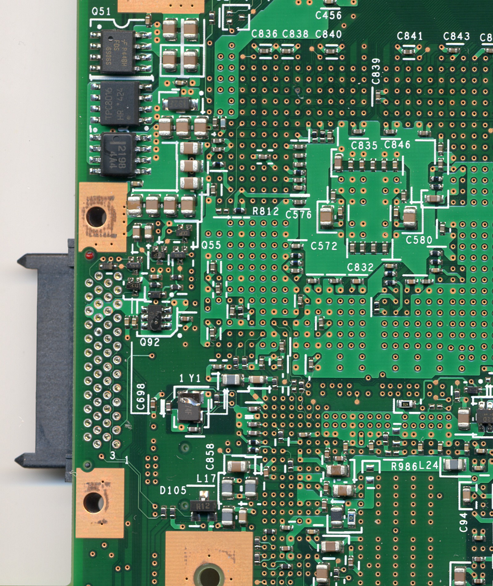

As I have a vested interest in also getting this information (I'm planning to do a re-flow on a T41 motherboard as well), here's a fairly detailed scan of that area from a 93P3307 board:
http://www.kawakami-ca.com/ibm_t41/93p3 ... pe_720.jpg (913KB 1600x1900)
If you need more detail (or less) of that area, or any other place on this motherboard let me know.

Note: After posting my scan I almost immediately got a PM from sojourner about what looks like a cracked or partial component near the "1 Y1" (about 1/3 the way up the image, left of center). The part is whole; what you are seeing on the scan is some glue residue on top of the part. The scanner's light is reflecting off the surface and makes it appear darker than the rest of the top. You can see the same thing on Q92.

rkawakami, thank you very much for the picture! I have too 93P3307. However there are slight differences (or i have lost some components). I modified your picture a little:
http://koti.mbnet.fi/~juhpal/marked.bmp (sorry to use bmp format... I did it quick)
The components marked in blue in the picture above came off the board. The plastic tape was glued to them, so they just came off glued to the tape (that is how I managed to save the components, I hope:) Other components stayed on place (and all will stay in place if you take off the tape).
In my board there are no soldering taps in place of diode(?) 1. I think I have lost component 2 (transistor or diode?) or most likely didn't have it in my board? Can someone check his/her board for this component 2, what does read on it?
Also if someone could use multimeter to measure resistance (or use bleeper) between the red dots I have marked on the picture? My board reads 0 ohms... I think there is a short somewhere.

juhpal, I too have a FRU 93p3307. It looks just like Ray's (great) picture ... so you are missing components. Being these are BLACK and about the size of a flee, did you look closely on the tape to see if they are stuck there? Did you check the work area for the tiniest bit of a black spec? Hope you'll fine them, and if not there may be someone to pass parts along from a trashed board or perhaps you can even buy one cheap (with bad GPU) and use it for parts!
Checked resistance you wanted, it's 800 ohms.

juhpal, why don't you post us a closeup snapshot of your board (for that area).
Looking at this MOBO, for that area, solder pads are not tinned unless a component was mounted. Thus it should not be hard to figure which parts go where ... but we need a pic of YOUR board!
Regarding the short at Q55, some thoughts:
1. improper soldering of reinstalled components? (traces shorted)
2. heat damaged component caused failure, thus short
(BTW, for others following this thread, do NOT bring your temps over 255c when reflowing because most components cannot handle temps over 260c for very long without damage. I would reflow at 250c, hold for no more than 5 seconds)
3. diode mounted in wrong direction
4. solder balls under Intel North? South? bridge have shorted (possibility because the short is in proximity of that BGA)
misc notes:
- component #1 appears to be a diode (determined bywhite band)
- the only other components there are resistors (solid black rectangles, two contacts), capacitors (tan, two contacts), transistors? diodes? with three legs
If you can post a PIC I think we'll be more likely to be able to help.

Don't see anything that should not be able to be fixed. Saw the area to the left of Q55 where the (3) caps go. The thing you said is a diode ... not sure about that ... not sure that's what it is and see no place for it. There IS a spot where it looks like a transistor(?) is missing. It is to the upper right of Q92, three pads where our MOBO's have a transistor/diode(?) mounted ... but you don't have one of those as extra parts? Are you sure the 'xtra' component you have is not a three legged component (hard to tell from the pic)?
If you are equipped and willing to put in time, you might want to clean up some of what looks like solder spatter (soft tooth brush or Q-tip and rub gently ... little Isopropyl), blow it off and double check what's been reinstalled to insure no shorted pads, traces. If it helps, I use a grounded low watt soldering iron (20 or 30 watt) and TIGHTLY wrap a piece of solid copper electrical wire around the tip, it has a sharp point filed or ground onto the end. This gives even less heat to the new tip and gets right in there for those smaller than a flee sized pads! It's great for installing SMC as well as removing. Another tip I've come across, it sometimes helps to use a little superglue with a tooth pick to stick the component in place, then solder. Sometimes you can get away with holding it in place with a toothpick, then solder.
In my old age have also found it VERY helpful to have an Optivisor, magnifying glass, eye loop and BRIGHT light on the desk for this type work.
Works wonders to get the job done!

The solder blob by Q55, was that from your iron or spit from the BGA above?
Also with regard to Q55, when I tested I checked for RESISTANCE, not continuity. There is continuity (a bleep as you say). Resistance is approx. .8K
Won't be around again for the next day and a half or so. Hope more of the other guys will jump in there, I know we have technical guys visiting (and I'm just a hobbiest), we encourage your input.
Basically sounds like we need to figure out where the 'xtra' diode goes and why there isn't a three legged component for the three vacant pads mentioned above.

Yes, I still think that this MB can be fixedsojourner wrote:Don't see anything that should not be able to be fixed. Saw the area to the left of Q55 where the (3) caps go. The thing you said is a diode ... not sure about that ... not sure that's what it is and see no place for it. There IS a spot where it looks like a transistor(?) is missing. It is to the upper right of Q92, three pads where our MOBO's have a transistor/diode(?) mounted ... but you don't have one of those as extra parts? Are you sure the 'xtra' component you have is not a three legged component (hard to tell from the pic)?
Thanks for advice!sojourner wrote:If you are equipped and willing to put in time, you might want to clean up some of what looks like solder spatter (soft tooth brush or Q-tip and rub gently ... little Isopropyl), blow it off and double check what's been reinstalled to insure no shorted pads, traces. If it helps, I use a grounded low watt soldering iron (20 or 30 watt) and TIGHTLY wrap a piece of solid copper electrical wire around the tip, it has a sharp point filed or ground onto the end. This gives even less heat to the new tip and gets right in there for those smaller than a flee sized pads! It's great for installing SMC as well as removing. Another tip I've come across, it sometimes helps to use a little superglue with a tooth pick to stick the component in place, then solder. Sometimes you can get away with holding it in place with a toothpick, then solder.
Yes, those are from my iron (and all the other mess:). But I think I didn't cause a short, but I have to double check it...sojourner wrote:In my old age have also found it VERY helpful to have an Optivisor, magnifying glass, eye loop and BRIGHT light on the desk for this type work.Works wonders to get the job done!
Last comments:
OK, that gives some hope... But my multimeter measures almost 0, so maybe there is a shortsojourner wrote:Also with regard to Q55, when I tested I checked for RESISTANCE, not continuity. There is continuity (a bleep as you say). Resistance is approx. .8K
Thanks for encouraging, I won't give up yet. But now It would be helpful, if someone figured a place for that small SMT diode on the right in this picture:sojourner wrote:Won't be around again for the next day and a half or so. Hope more of the other guys will jump in there, I know we have technical guys visiting (and I'm just a hobbiest), we encourage your input.
Hope you can get this back up and running soon!
http://koti.mbnet.fi/~juhpal/Picture%20024.jpg
I guess if no-one won't find a place for it, I will try to boot the board without it

Hello,
Tried to boot the mainboard today. Got smoke
-> Time for a new mainboard. I hope that the processor didn't toast... So there was a short in the northbirdge. Be careful when reflowing these boards!
Sorry to here about the board, you put a lot of effort into repairing it. At least it has been a learning experience for us and this thread can help others in the future (the GPU issue has become sooo big). Thanks for sharing your experience!
