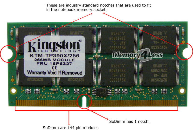

I also have IBM ThinkPad 600E 2645-4AU. It has 544MB of RAM. I using two Samsung 256MB PC100 SODIMM low density memory right now as we speak.
Here is the image link for Micron:
Also, here's some info for Micron:
MT16LSDF3264HG-10EE4 AVA 256MB 144p PC100 CL2 16c 16x8 SDRAM SODIMM T017 RFB U.S, Micron
Here is the image link for Samsung:
Also, here's some info for Samsung:
M464S3254BT1-C1H AEC 256MB 144p PC100 CL2 8c 16x16 SDRAM SODIMM
I got the source info from http://www.memoryten.com
http://www.memoryten.com/000934.htm and http://www.memoryten.com/001595.htm
It will work in your ThinkPad 600E.

That is why the no name, memory chips you guys brought on ebay doesn't work in your ThinkPad 600E laptop. Read my previous posts and click on the links.
You guys didn't do your homework enough when comes to upgrade the memory for your laptop. You see I work on other people's computers and when they ask me to upgrade the RAM on their computer. Do you want to know the first thing I did?
What I did was the customer's computer have the original memory inside when they had it when it was new from the store or shipped new from the factory. I took the original memory chips out and photocopy it on the copier machine and put the make and model name next to the images. You could also scan it on the flatbed scanner and print it out on the color printer from the computer.
Then, I will search for two (2) 256MB PC100 SDRAM SODIMM chips in Samsung, Micron, Infineon, or Kingston name using the manufacturer's part number on ebay, Craigslist, or other online store for a decent price and not too expensive.
Also, I will also find them in the local computer repair shops in my area where I live at and sometimes they carry extra used memory for real reasonable price. That's how I got two (2) Samsung M464S3323CN0-L1L for my ThinkPad 600E for $35.00 each at the local computer repair shop. I don't go there to get my laptop fixed, I go there to get used computer parts they gutted out of other computers.
This is the Samsung memory chip I'm currently using in my ThinkPad laptop 600E right now typing away in this forum.
Samsung 256MB SDRAM Memory Module (PC100/ 100MHz/ 144 Pins) - M464S3323CN0-L1L
Infineon 256MB SDRAM Memory Module (PC100/ 100MHz/ 144 Pins) - HYS64V32220GBDL-8-C2
Kingston Technology SDRAM 256MB KTM-TP390X/256 Non-ECC Unbuffered CL3 144-Pin SoDimm Memory Module

2645-550 does not accept 256Mb memories?
I tried twice, the eBay vendor is a very good one and exchage me the first ones they sent, but same result. Now they are refunding me the full selling price...
He tells me that my 600E model 2645-550 DOES NOT accept 256Mb memories, only 128 ones as maximum. But I feel to have read some one with the same model to be succesfull installing 256Mb ones.
Is there anyone that could confirm to me that 2645-550 is able to run with 256Mb memories? If yes, which brand or part number has been used?

Why do you insist dealing with this vendor? I told you in my recent posts that my ThinkPad 600E 2645-4AU accept two (2) Samsung 256MB PC100 SODIMM 144-pin SDRAM (M464S3323CN0-L1L). Check out the ebay links below And look at the pictures.
http://Search Results for M464S3323CN0-L1L
http://256MB PC100 Memory 144pin SDRAM SODIMM Laptop RAM
http://33L3070 Samsung 256MB Laptop Memory M464S3323CN0-L1L 33
http://256Mb PC100 16 chips 144-pin SODIMM SDRAM LAPTOP MEMORY

Keyhole,
I tried the first time because they told me their memories were compatibles. The second time because they offered me interchange with new ones.
I'll try now with the links you offer me (thanks for it!!!), but my question is: will the 2645-550 accept 256 MB memories? Because I have been told that NOT ALL the 600E accept them, and being my 550 one of the earliest ones (in fact I had to do the hardware mod to have it running at 100MHZ), I'm not so sure that it will accept them.

fjefje wrote:Thanks again!![]()
I'll look for all of them and also for the search method you give to me.... I also sent question to the seller to be sure they are compatible with the 2645-550 model.
And if they are, the budget (price) will be determining what and when I'll order them.
Just ask them if the memory you about to purchase have 8 chip per side (16 chips total) and PC100 only not PC133.
Also make sure they email the picture because majority of vendors do not update the pictures, they use one (1) blanket picture for all the PC100 memory they sell.
Then make sure it is a "known brand name like Samsung, Micron, Infineon, and Kingston".

Keyhole, thanks for the suggestions... I'll follow them. But for budget reasons, I'll have to wait till the end of the month. Hopefully I will still find some opportunities in eBay as the ones there are just now.
Looking in your previous posts you said you are running just now Samsung ones, but if I look for the p/n you give to me, will I find also the other known brands as Micron, Kingston, etc?
(Provided it is possible at that moment to find them in eBay, that just in this moment there are none... hopefully the stocks are being updated and this is the reason for it).

tfflivemb2
- Moderator1
- Posts: 5532
- Location: Wisconsin
Re: 2645-550 does not accept 256Mb memories?
As I just began reading this thread, I was looking for your model 600E. I can tell you that I have run into problems with these 600Es. They have a different BIOS than the 4AU that the other poster mentioned. It is definately an older model Thinkpad.fje wrote:He tells me that my 600E model 2645-550 DOES NOT accept 256Mb memories, only 128 ones as maximum. But I feel to have read some one with the same model to be succesfull installing 256Mb ones.
Here are the affected models: 600E (2645-55x,A5x) The thing to look for is the 5's in the last three digits.
I had nothing but failure using several known working PC100 Low Density ram sticks in my 2645-55U. I was able to get the same sticks to work in my 600E 2645-8BU, and other models, such as the 4AU like the other poster mentioned....
