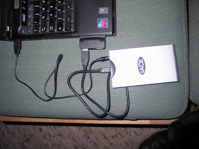

The problem with your external disk on the PC-card USB could very well be inadequate power supply from the pccard. That was the case by me, the solution is using a separate lead to the original ports on the T40 directly to the power socket on the HDD.

I must open the pc and change plug of electric cable ?
Re: t40 doesn't recognize usb ports
No, you do not have to do anything to your T40. My external HDD has two plugs: One a USB connection, which usually does it alone. The other (a little round hole) is a plug for power supply to the disk (5V DC). If you connect the USB cable to the PCcard-usb-port and the power plug using a separat cable to the T40's original usb-ports, I think it will work. But of course, you have to have such a cable, in my case it was supplied with the external HDD (LaCie).

Here's a picture:
The thin lead is the separate lead for power supply. Hope this helps!

It should work OK in this configuration... Just press the data USB cable deeper into the PCMCIA USB port
If the HDD is not spinning at all, your internal USB ports are completely dead
