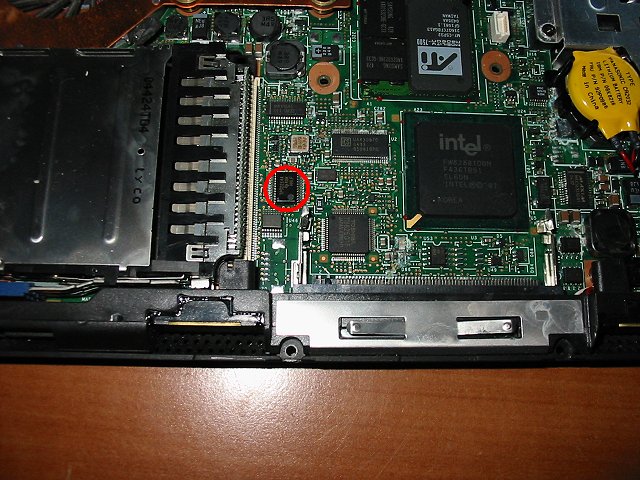

I have got a roasted chip just to the right of the pcmcia box.it is the middle of the 3 big black chips adjacent to the pcmcia slot(the one below the silver coloured chip].what chip is that...I want to know for curiosity sake what is toasted .The board has been declared untouchable by the repair shops here.

edit2: Here's what I found on one of my dead T41 motherboards:
<-- Clickable image for 640x480 pixel version; 101KB
If the component I've circled in red is the one you are asking about, then it's a Texas Instruments TPS2214A (Dual-slot PC Card Power Switches).
ref: http://www.datasheetcatalog.org/datashe ... s2214a.pdf
<-- Clickable image for 640x480 pixel version; 101KBIf the component I've circled in red is the one you are asking about, then it's a Texas Instruments TPS2214A (Dual-slot PC Card Power Switches).

Thanks a lot.
Yes, the chip you have circled is the one i wanted to know about.
It had gone bust with the services of a good engineer . I will have to look for some other cause then , as to why my board
refuses after that to boot. Anyway , even in its termination i have learnt a lot.

The chip is the power controller for the PC card slots. It is certainly replacible if you are sure that is the problem

When it got toasted there was a lot of smoke which came out and when i saw the region around that chip it is also
probably roasted. I dont know how to post photos otherwise it is a site worth preserving.Probably a lot of other damage might have been done.
