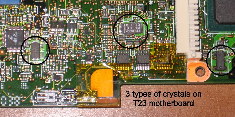

The two inductors on the bottom should be these:
- L8 will have "5R2" on the top row (with some other characters below it but they are not important); L11 will have "2R5"
The one on the top side of the motherboard next to the CPU (L9) will have "0R6NH". If you have an ohmmeter (multimeter) then you can test them to see if they are "open". With no power to the motherboard, set the meter on the lowest resistance range and put the leads across the two metal tabs; for the L9 inductor, use the two contacts that are on the same side of the part. You should read 0 ohms or very close to it. If these three are firmly connected to the motherboard, then there must be some other component(s) that are loose or defective.
I would recommend checking at least one of the crystals on the motherboard. I had a problem with Y6, just below the Intel 82801 chip and located underneath the speaker assembly. Two legs had microcracks in the solder joint and it caused the system to hang.
ref: http://www.kawakami-ca.com/images/t23_crystals.jpg

Got my hands on a multimeter, all the inductors rate at 00.6 i tried it on the bottom 2 pins on the right most crystal and got about the same couldnt get a reading on any of the other pins or on the other 2 crystals
- Posts: 10053
Re: t23 problems
Inductors will read almost 0 ohms since all they really are is a large amount of wire wrapped around in a coil. Crystals cannot be tested with a ohmmeter; they would need to be placed into an oscillator circuit and measured with a frequency counter. Unless you can find something else on the motherboard that is not firmly attached or has obvious signs of distress or swap out the CPU with one that you know works, this is about the time that I would suggest that the motherboard is dead.
