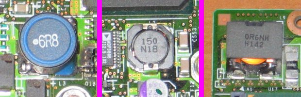

This may not apply to your x41 (as it's based upon my experiences with the T23), but there could also be a loose/detached inductor on the motherboard which is preventing the battery from being charged. Well, that and also the battery charging IC could be defective. Most of the Thinkpad motherboards I've looked at use a Maxim IC (i.e., MAX1645 in a T41). Google the MAX1xxx part number to confirm it's a battery charging controller then look around that area for an inductor like the middle one in this photo:
http://www.kawakami-ca.com/ibm_t2x/t23_inductors.jpg
edit: A loose inductor will cause the lack of charging but it shouldn't affect the reporting of the battery's data. That does sound like a fuse or perhaps a battery charging IC problem.
