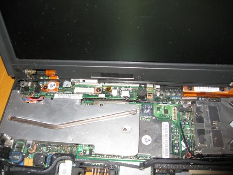

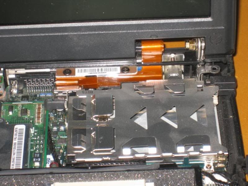

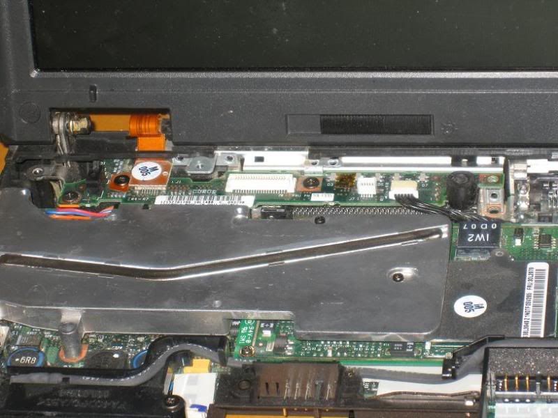

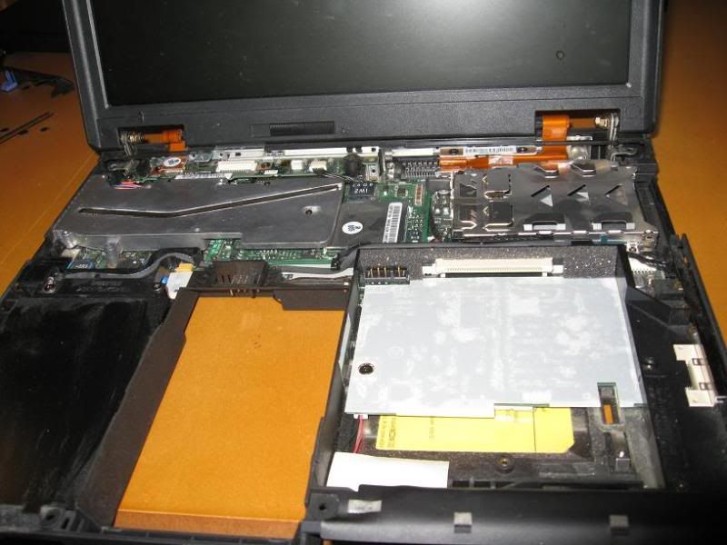

I just took 600x apart (too many screws lol!!!), and looked in the areas you suggested. Still the same problem, I can only see the display at extreme angle. Tested the switch on the left, and it turns monitor off while I press it down. So its gotta be inverter or backlight? Anything I can check in more details, perhaps measure voltage with multi-meter if I can get to any connector vias? Or should I just replace one thing at a time? Where can I get replacement parts? Not sure if from your signature you suggest to have spare parts?
For your reference, I took a few snapshots of the laptop inside.
http://i42.photobucket.com/albums/e328/ ... 600x-1.jpg
http://i42.photobucket.com/albums/e328/ ... 600x-2.jpg
http://i42.photobucket.com/albums/e328/ ... 600x-3.jpg
http://i42.photobucket.com/albums/e328/ ... 600x-4.jpg
Thanks!!!

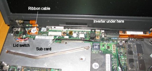

Using one of your pictures, I've added notes on the items to check:
http://www.kawakami-ca.com/ibm_600x/ima ... onents.jpg
If you haven't done so already, re-seat all of the following: the Sub card, the ribbon cable that plugs into the Sub card and the inverter. If none of those things were loose, then leave the LCD bezel off and get something like this:
http://cgi.ebay.com/ws/eBayISAPI.dll?Vi ... 0335360083 (600X backlight - 10L1350 $6)

With that (closely read
) description, then you might be having a problem with the ribbon cable, motherboard or LCD panel. At this point, I'd re-seat the ribbon cable connector (the one visible in your ThPd-600x-4.jpg photo) to the motherboard and also the one located at the back of the LCD panel. When you have the panel dropped out of the lid assembly, give a good look at the ribbon cable along its entire length and see if there's any cracks or tears.
