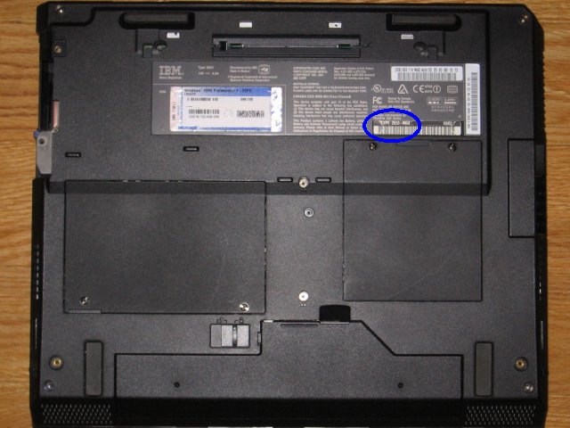

- Posts: 10053
Re: Problem with wireless internet Thinkpad A30 - Please help!
@Davincimath: In case you are still around, here's a picture of where to find your TYPE number on the A30 (I think it's the same as on an A31): http://www.kawakami-ca.com/images/a31p_type_label.jpg

Davincimath
- Posts: 8
- Joined: Thu Jan 07, 2010 5:00 am
- Location: Long Beach, CA
Sorry if I took way too long to reply, I'm kind of delaying because of errands and stuff...
TYPE 2652-46U is this it?
