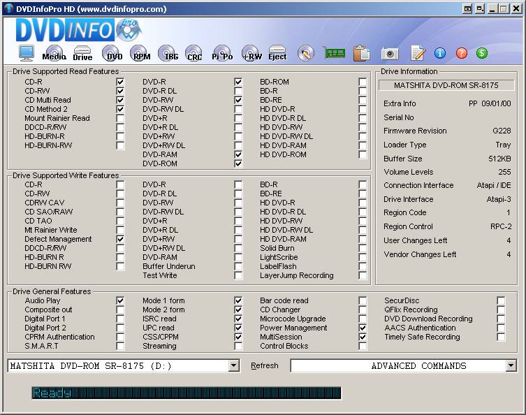

Took me a little while to find an SR-8175 drive in my stockpile but I found one, installed it into a T23 and used DVDInfoPro to read the drive's capabilities. That program reports that DVD+R is not supported (nor are DVD+RW's either it seems).
ref: http://www.kawakami-ca.com/images/sr-8175.jpg (753x594 100KB)
