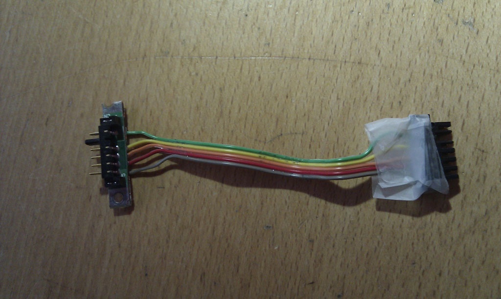

I looked at the battery connector of my T40 battery, and the T30, and they looked identical. They also both had the plus and minus sign at the same sides of the connector, so i just went for it and soldered an extension cable for it.
I used the Ultrabay connector battery board thingy that is found in 15" T4x
I used a saw and Dremel to cut the PCB in half, so i ended up with 1 male battery connector, and 1 female connector
Put a cable between in, and tadaah my battery connector extension cable is done!

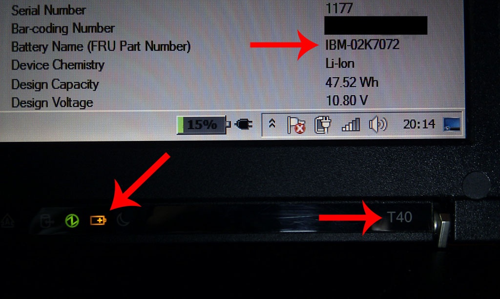

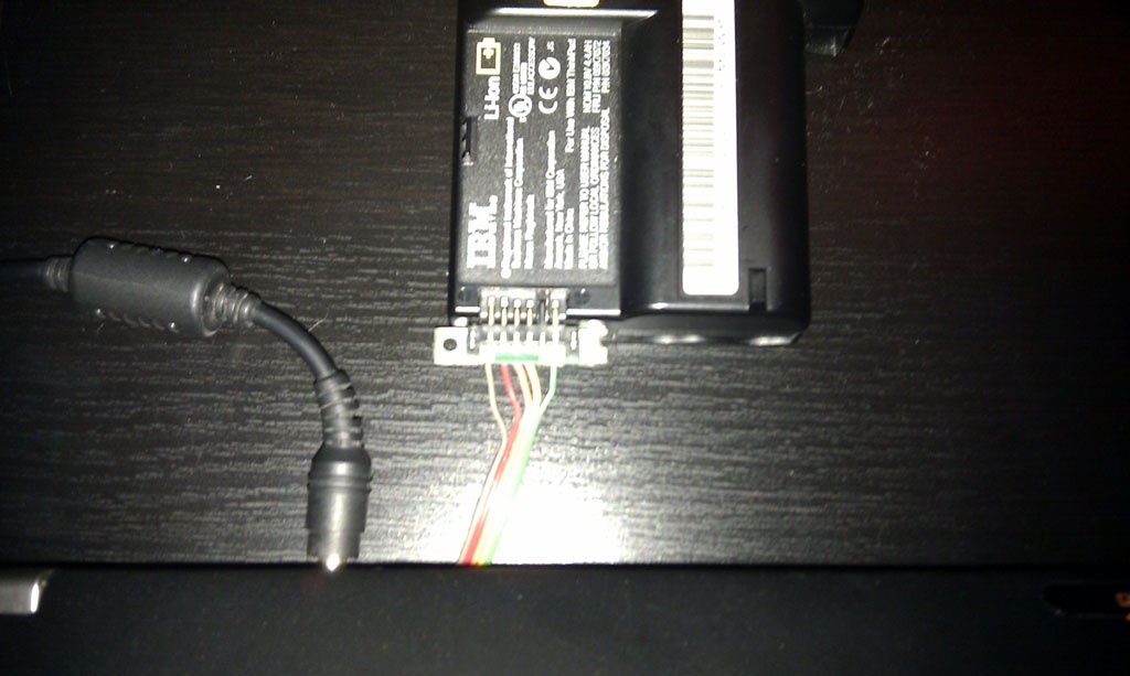

I tried it first with the T40 battery, and it worked fine.
Then i just did a small wish and plugged the T30 battery in... and PRESTO it works :P
I verified this by going to the Battery MaxiMiser program and look at the battery details. It read out the battery cycles, serial number (which matched the one on the battery sticker itself, so i knew it was working)

The T30 battery connected to the T40:
http://tweakers.net/ext/f/Ln5FW1ZQCQfQk ... 5/full.jpg
Proof of this hack:
http://tweakers.net/ext/f/6geaZYa99ChFb ... 9/full.jpg

I applied the Scotch tape for insulation, the inside of the T40 has some metal parts and i don't want any free sparkling effects :lol:
