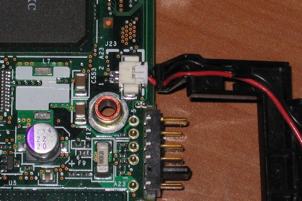

Here's a close-up of the T23 CMOS battery connector: http://www.kawakami-ca.com/images/02k65 ... 2k6715.jpg (inset photo, left side, labelled "T2x") With the connector's electrical contacts facing up, the red (+) wire is on the left. I would assume that whoever designed the motherboard would have put blocking diodes in the circuit to prevent any problems with reverse polarity.
When viewed from the top of the motherboard (i.e, keyboard removed), the black (-) wire goes on the side where the Ultrabay connector is and the red (+) wire goes on the side where the main battery terminals are. Two more photos:
http://www.kawakami-ca.com/images/t2x_c ... ctor_1.jpg
http://www.kawakami-ca.com/images/t2x_c ... ctor_2.jpg

#6 Post by ozzymud » Mon Aug 01, 2011 8:57 pm
Thanks for the pics. I just got my T20 battery in from eBay today, while transferring the battery to the caddy... I was thinking red goes here, red goes here.... then just as I went to put the new battery into the caddy... brain fart :P
Your pics let me see which way it went :) No more error on boot :)
