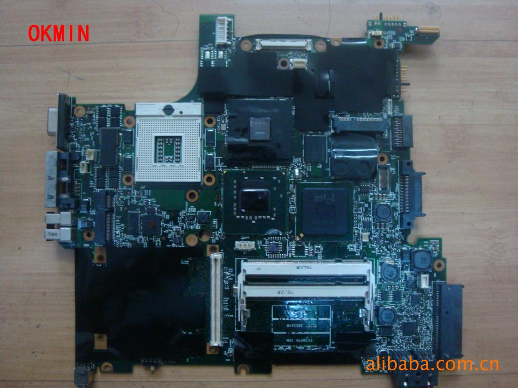

Hi, I have one of the faulty nVidia boards - FRU 41W1489 - in my T61 7665-12G, unfortunately I were too late to get it replaced by Lenovo, so now I have to find an Intel version - I just got one of the first warnings today, the videodriver stopped working eventhough I keep my laptop as cool as possible 56 - 65C.
So I have been looking for the FRU 41W1487 with the Intel videochip but I cant find any that are not too pricy, so my question is: are there no other alternative boards that can be used in this model? What if you disregard the Firewire port? I can always block the hole with some plastic and superglue.
My concern is just that it has to work with the rest of the HW and fit into the casing. Also, I would like to still be able to get the 1440x900 resolution.

It must be the same size, so the 41W1487 and 42W7866 will work. The others won't fit. Your nVIDIA fan will work with Intel graphics. (not the other way around). Everything else is the same. 1440X900 is no problem.

Hi again and thank you for your answers:) I did a search on google and unfortunately there are allot of mainboards for T61, so i used some time to put the following together and hope that you guys in this forum will help to correct it if something is wrong:)
Replacement board for T61 7665-12G FRU 41W1489:
Intel x3100:
41W1487, 42X7318, P42W3782 http://i01.i.aliimg.com/photo/v0/261211 ... rboard.jpg
42W7866, 43Y6900, 42X7351, http://wine-in-a-box.org/ebay/thinkpadt61MB.jpg
nVidia, 140 and 570:
41W1489, 43Y9044, 42W3784, 42W7776 14.1" http://i03.c.aliimg.com/img/ibank/2010/ ... 998829.jpg
42W3813/42W7651, 42W9399/42W7651 http://www.netbook-battery.net/images/2 ... 2W7876.jpg

EDIT: Is it possible to use the mainboard from another model, and if so then which FRU to use?
Would this R61 mainboard not work with the LCD and the casing?
41W1485
http://img.alibaba.com/wsphoto/v0/42390 ... 1W1485.jpg
http://i24.ebayimg.com/08/i/001/07/45/f969_35.JPG
T61 41W1489:

Re: New mobo for T61 7665-12G?
R61 would not work:( The VGA is on the right side, on the T61 its on the left side:(
Live life to to fullest:) I do!
