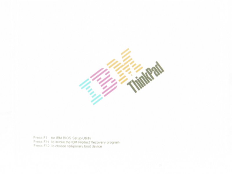

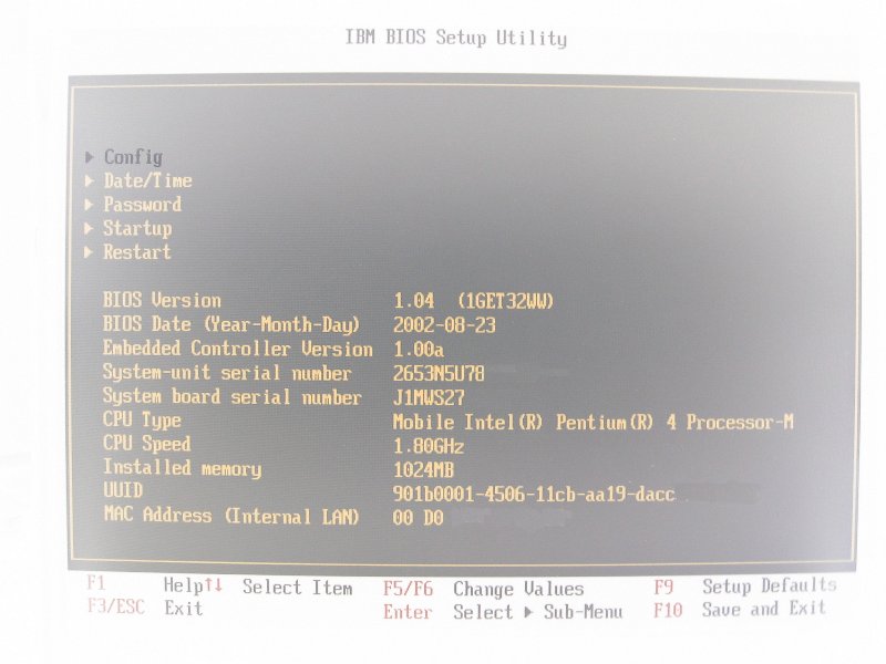

Re: T61 only display's in Greyscale color's!
http://i54.tinypic.com/2q1t112.jpg (1024x768; 187KB)
http://i52.tinypic.com/2yl7ecl.jpg (1024x768; 178KB)

Images are not true greyscale as I see some yellow and red (unless that's a function of your camera's white balance). You are right; it's more of an inversion or negative. I believe the BIOS background should be white and the characters blue (white for selected item). Your screen shows the background black (opposite of white) and the characters yellow (negative of blue). The Fn key legends are supposed to be cyan (light blue); the invert is red.
At this time I'd suspect the ribbon cable, the connection on either end of the cable or the panel to be the problem. I'm not sure if the T60 screen is swappable. You can check the Hardware Maintenance Manual (HMM) to see if the T60 and T61 share a common display.

edit: Here's some Paint Shop Pro "negatives":
http://www.kawakami-ca.com/images/splash_neg.jpg (IBM red/green/blue is replaced by cyan/purple/yellow)
http://www.kawakami-ca.com/images/BIOS_neg.jpg (Note the slight reddish tint to the F1, F5/F6 characters)

There really isn't any red, it's hard to get good lighting for a picture but it really is like a "film negative". I was thinking myself it might be the ribbon cable, maybe I pulled on it at some point. I checked for kinks but it looks good. Bacllighting works good, and I can use the FN key to turn the brightness up and down so that's good. This sucks. Color's worked great before.

Ok, i have noticed some of the bios options are in red, eg; F10 to exit and such are in red. Right now I have the lcd out and I'm booting the system with the lcd out of the laptop to make sure the rear lcd cable is secure. Still no luck, even when I'm playing around with the cable... like lightly pressing on places on the cable and the back of the LCD results in no change in the greyscale changing to color.
