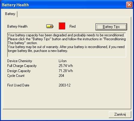

Hello
My T40's battery has lost capacity in the last years. I checked it with IBM MaxiMiser.
As you can see, the health is red, and the remaining capacity is 20.98Wh.
I don't have the button "Improve battery health" on my T40, but a friend with a T42 has it. Will it help if he insert my battery in his T42 and runs the "Improve battery health" wizard?

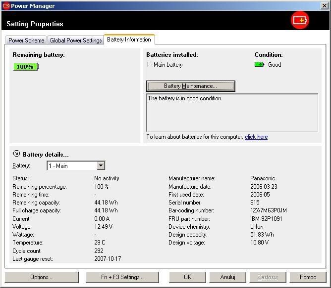

#3 Post by AdaSch » Sat Oct 27, 2007 2:14 pm
look on my 240 cycles,
br

AdaSch wrote:look on my 240 cycles,
Look at your battery manufacture and first use dates! 2006-03-23 and 2006-05!
As has been said many, many times here, rechargable Li-Ion battery technology degrades with time whether you use it or not.
frankiepankie's battery first use date is over three years ago, so the numbers he is getting are not at all surprising.

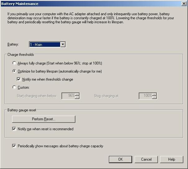

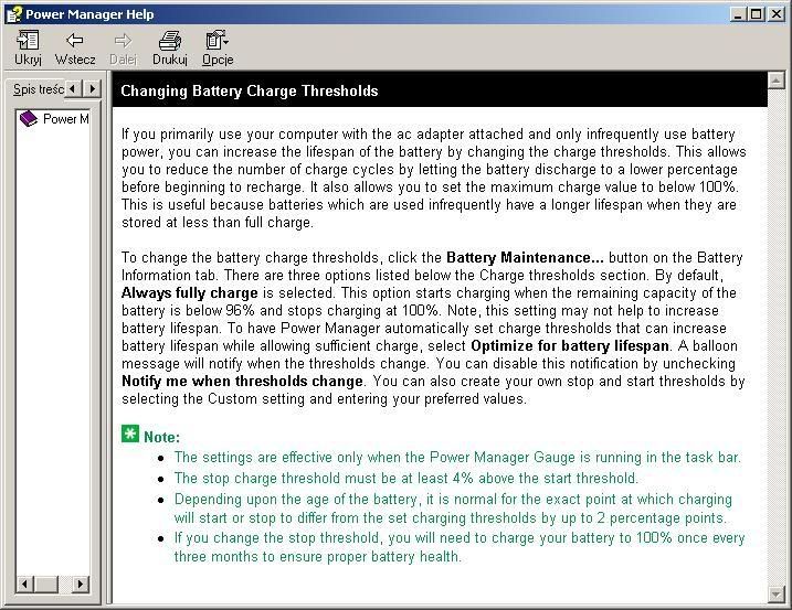

#11 Post by AdaSch » Sun Oct 28, 2007 4:18 am
You have right Bill,
Image,
but, new t43 power manager have this option
and note from help
t40 don't have this option...

#19 Post by frankiepankie » Tue Jan 01, 2008 12:38 pm
WOW! :shock:
Panasonic is indeed, a LOT better.
292 Cycles, and still 44Wh of the 53Wh remaining
That is amazing
Lenovo ThinkPad T410

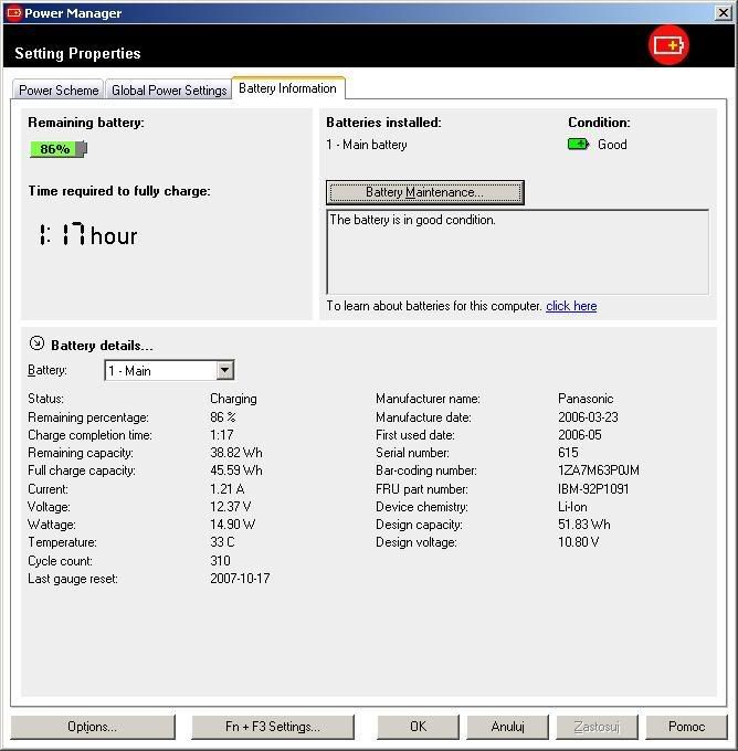

#24 Post by AdaSch » Thu Jan 17, 2008 8:11 am
look on 310 cycles! capacity rising up!

#25 Post by frankiepankie » Fri Jan 18, 2008 4:50 pm
Nice!
Panasonic batteries rock!
310 cycles and IBM Power manager software says "Your battery is in good condition"
8) :lol: :D
