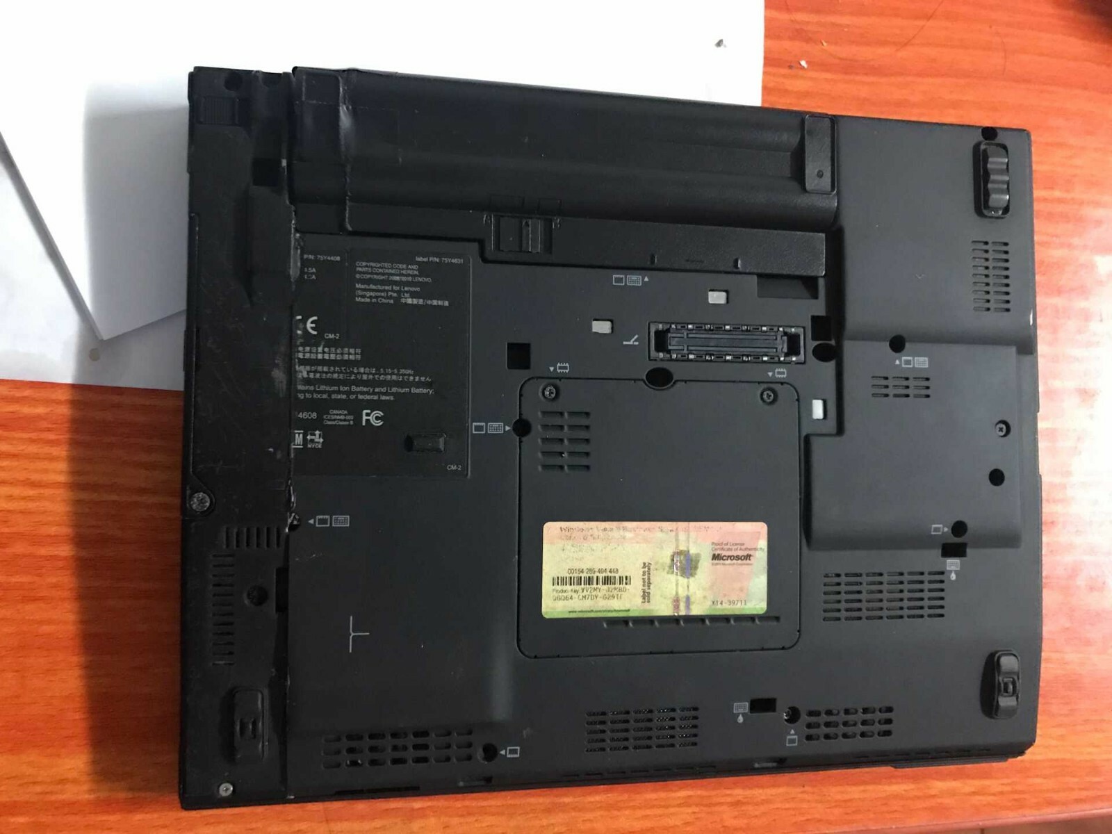

Looking at the pics, it has a cut-down X201 bottom case, with the right side of an X61 grafted in.
That has to be one of the strangest Frankenpads I've ever seen.
dmdsoftware
- Posts: 433
- Joined: Mon Apr 11, 2005 2:24 pm
- Location: Mississauga, Ontario, Canada
Re: x201 screen mod, can I put an x61 1400x1050 screen on it
He did the same thing with a X210 board.
I observe that the battery is an X61 battery. In other capture shots from the X210 board version, I saw the audio and usb plugs on he right side lined up, so it must be using the original daughterboard of the X61/X62. The power plug appears both on the left and right side of the laptop, but it appears the correct plug is the one on the left side. I think the only reason the left side of the laptop is replaced with the left side of a X201 is to get ports properly covered. I'd like to see how the screen cable is handled.
I am shocked how similar the X61 and X201 are for this frankenpad to be possible.

- Posts: 4413
Thinkpad4by3
- Posts: 2670
- Joined: Sun Aug 09, 2015 9:25 am
- Location: N. Bellmore, ny
X61 batteries have the release slider on the machine while the X201 batteries have it on the battery. There's all the proof you need.axur-delmeria wrote: ↑Thu Mar 07, 2019 5:31 amIncorrect. Compare this X61 4-cell battery with the underside of the Frankenpad.
dmdsoftware
- Posts: 433
Good eyeballs you guys have.Thinkpad4by3 wrote: ↑Thu Mar 07, 2019 9:07 amX61 batteries have the release slider on the machine while the X201 batteries have it on the battery. There's all the proof you need.axur-delmeria wrote: ↑Thu Mar 07, 2019 5:31 am
I'm just looking at the photos I archived of the same frankenpad hack with the X210 board in the X61 and the battery has the mechanism as well.
I also realize now I've been looking at the photo wrong the whole time. I left thinking the zipper part is close to the side with the vent, but it is the opposite side. So, the bottom of the Thinkpad is 95% X210 shell (and the top being 100% X61).

It helps that I have an X60 Frankenpad as a toy.
X200/X201 and X60/X61 LCD cables have the same connector at the motherboard.
sent from my iPhone

Nice, I'm also suspecting the keyboard connector is identical.
If one were to have a spare X61 AFFS with a dead motherboard and a good X201 motherboard but dead screen.... the marriage of the two would create an ideal Thinkpad. It's not worth buying a X210 board for cramming into a X61. If you are shelling out $$$, makes better sense to buy a better screen for the X201 and modding it to the X210. The Sharp screen is very nice and I understand there are even better 3K screens available that will now work with the X210 motherboard.
