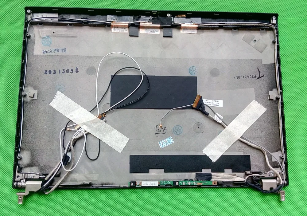

Got my x220 in and went to do a test fit with my already-modded screen (...ea3). boutch55555, you were right, it is rather tight vertically, though with some sacrifices, it may have worked.
That said, I had a backup screen (again ...ea3), as I thought I'd break the first one for sure, to try a different approach on. I decided I'd test your hypothesis that the controller PCB could be flipped to the other side of the panel. It's possible, just not in the way that I thought it would work. The panel can't be "swung" 180°, but it can be "slid" back behind the PCB with the same orientation as before. This saves about 6 mm off of the bottom of the panel, however, swinging the PCB behind the panel does increase the depth a bit, but it should still fit in the lid.
Here's the pictures of the process that are probably more informative than I could be:
http://imgur.com/a/WTSdw
Summary of process:
-Strip the foil from the panel
-Unscrew panel from backlight grounds
-bend grounds 180°
-peel a bit of the glued FFC so that the panel is free to slide up
-cut 1 cm of the left of the PCB off so that the backlight power supply cable can stretch
-screw everything back in
-profit

#40 Post by phage » Tue Jul 11, 2017 12:36 pm
On the x220, what was your method of approaching the hulking mass of WiFi antennas? They're very much in the way; I suppose they could be replaced by slimmer ones, but I wonder if they can be bent flat without losing reception. If this was possible, they would just sit behind the screen.
I simply removed the wlan antennas, as I don't use a wlan card for battery reasons.

My issue was that the antennas in the bezel, near the top, are too large. The solution for the antenna for the 3G/4G WLAN was easy, because I don't use them, so I simply removed the antenna block and put it aside. However, I want to keep WiFi, for obvious reasons, but they're still in the way.
If I misread the question, I apologize. Also, the WLAN antennas are actually bigger, so using those would come with their own set of issues.
Just cut the bottom or fold it. If that's not enough for you, try those

#50 Post by boutch55555 » Thu Jul 27, 2017 6:00 am
So, about those antennas... I got the new display assembly yesterday and the ones inside don't look like any other I've seen before. Looks like even wwan will fit with minor modifications. It says x220 on the bezel and came with a IPS LP125WH2-SLB1 (!!!), quite a steal for 50$. No FRU on the antennas, but lid is 04W2185.

Hey, that's pretty cool. I'm betting the seller just put non-stock antennas in there, but you came out with the better deal.
I ended up trying to bend the wifi antennas flat to accommodate the screen on top of them. Using the wavemon package in linux, I noticed an unusable drop in performance. I ended up ordering the antennas that boutch55555 recommended, and they work better (offer greater connectivity over longer distances, as determined by wavemon) than the stock x220 ones, which was certainly a plus, on top of being the correct size for the mod.

I think they are just another model, just more rare. Might be from a later revision when they ran out of the original ones. An image search for the lid FRU got me this one from Aliexpress with the 3 antennas setup. Having a closer look, they are labeled Lenovo DB. Variants on CAN43130 are available on ntb74.ru, but they seem almost identical to the other ones you ordered.
Can you share the numbers you got for stock / stock bent / replacement, I'm curious about what the range of variation is.
Edit : Did you bend it inward or outward ? Might have a big impact as the core is soldered to the top part and shield at bottom. The core wire can also break quite easily when bending outward, as seen here.

#55 Post by phage » Fri Jul 28, 2017 10:07 am
I bent it outward, such that makes the footprint larger for the antenna. I had to break the core wire connection and resolder it, which is (I'm sure) where I messed up.
With the new ones, sitting in the same location in my house, I'm getting a signal level of about -43 dBm. The originals, I believe were around -57 dBm (going off of memory here, because they're KIA); after breaking them, I was getting a link quality of about 12%. It's admittedly not a huge increase, but it's certainly not a sacrifice for the mod. I'm curious about using the AUX antenna connection to wire to a pigtail connection for a better gain antenna that you could take off in transport.
Using something like this:
http://img.dxcdn.com/productimages/sku_149922_2.jpg
I've ordered one (it's on the slow boat over) and plan on drilling into the case near the kensington lock. If anybody is interested, I can post findings on that too.

Thanks for the info, guys. Through the help of RP-SMA male-male and RP-SMA female-female connectors, I'm going to try to make a "port" such as would be flush with the casing, because I really don't want anything snapping off in a backpack.
It's a bit hard to explain because of the odd naming conventions, but I'll post pics when I'm done.

#59 Post by boutch55555 » Sat Jul 29, 2017 5:27 pm
Slowly getting there.
Hinge mod
Side view of top bracket. You need to remove the plastic part to do a clean cut on those.
Filled with epoxy because clips are gone. Might help to sand the surface.
All they has at local hardware store for padded double sided tape I'll try to find better one tomorrow before final assembly.
Guess I won't hold it by the screen anymore.
