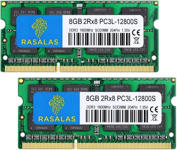

Today I installed 32GB into my W520 and it went without a hitch, and the performance is noticably faster in every way. My BIOS was already at v1.46 which I gather is the recommended minimum for use with 32GB? I also already had a quad CPU and 64-bit O/S etc. The RAM sticks were less than half the price of all the other ones I have considered over the past six years. The links to where I bought them from are below; I'm in England (UK) so the first link applied to me. I got the option to buy as a pair. If I remember to do so, I will run CPU-Z and find out the other specification details.
https://www.amazon.co.uk/dp/B08F7M219D? ... asin_title
https://www.amazon.com/Rasalas-1600MHz- ... r=8-1&th=1
