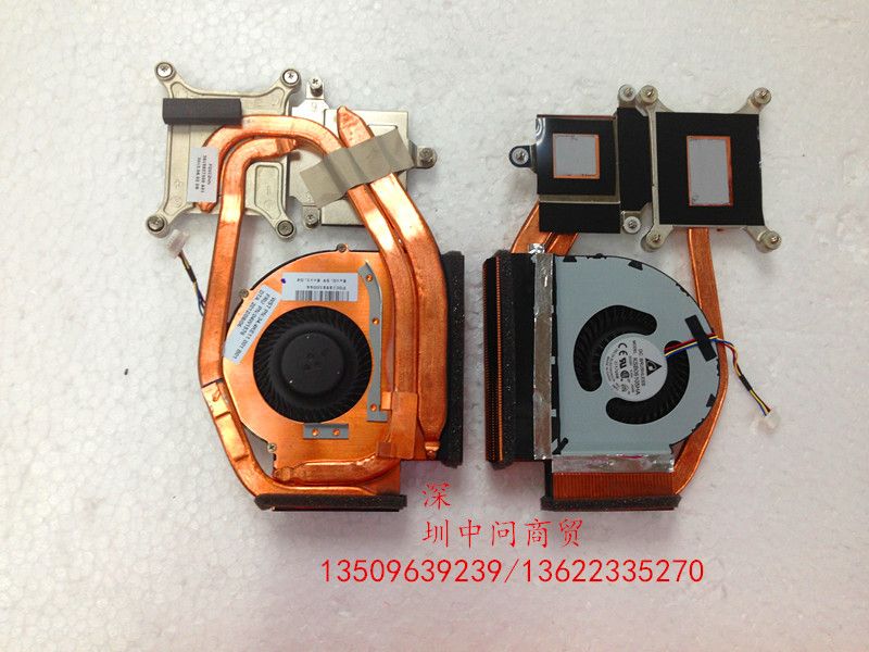

Everything went good, but I have problem with CPU cooling. I have 04W1576 (45W TDP) unit which works fine, but up to 96*C.
I decided to buy 55W TDP unit, but only one I was able to get right away in Poland was 04W0437.
Ok U might think what's the problem then ?
Well my old unit have bigger base for graphical unit. This bigger base covers nvidia's RAM too.
So my dilemma is, should I run on this 55W unit without cooling for graphics memory, or stay with 45W one, or maybe try to build new option from those two ?
But my biggest question is, was there factory option running on nvidia q1000m or q2000m with 04W0437 cooling unit ?
Maybe video ram don't need that much cooling ?
Here are some pictures:
04W1576 (45W TDP)
https://www.dhresource.com/0x0s/f2-albu ... lenovo.jpg
04W0437 (55W TDP)
https://cdn.shopify.com/s/files/1/2407/ ... b6cbb5.jpg
https://cdn.shopify.com/s/files/1/2407/ ... 806467.jpg
In my opinion best way might be to switch fans, and put one from 55W in 45W unit.
Or switch nvidia base, and put 45W on 55W unit.
And I'm still looking for one of those 04W1574, 04W1575 55W units. Which looks like mine 45W. And in my opinion has better heat pipes set too.
Please advise me.

I would suggest you to stay with your current 45W heatsink assembly, considering that it covers the graphics chip and its VRAM chips. If I were you, I would not want to run the risk of operating the VRAM at a higher temperature.
For the W520's configurations that came with a Quadro 2000M, yes. For those that came with a Quadro 1000M, probably not.
Probably, but for such a high-end configuration? I doubt that it is worth the risk.
According to the pictures that you have posted, I don't get the idea of transferring that 5V 0.23A Panasonic fan (UDQFLZR22FFD) to your 45W heatsink assembly. Your 45W heatsink assembly appears to have a 5V 0.4A Delta fan (KSB06105HA), which I believe, is more powerful than the 55W heatsink assembly's Panasonic fan.
The other 55W heatsink assemblies (FRU 04W1574, 04W1575), seems to be identical with your current 45W heatsink assembly. I did not notice a difference with their heatpipe configuration. The fan also seems to be the very same Delta KSB06105HA.

Thanks for you reply.
Well You are absolutely right, I don't see any difference between FRU 04W1574, 04W1575 and what I have.
I wonder if that's scam like with 4338 USB 3.0 docking station.
Only difference I see is between 04W1574, 04W1575 and 04W0437 - this one has much more massive bases, but VRAM chips aren't caver at all.
I am able to get new 04W1574 in Poland but it is reader expensive. I wonder if I will get any lower temps for that.
Maybe I need to consider "welding" bigger GPU base from on 04W0437.
But again I thing those 3 heat pipes together will work worst than 2+1 configuration.
There Will by more heat in one spot, and one pipe will have longer way to exhaust port.
Well honestly I don't know what to do, and still 96*C is a bit to much, right ?

Take a look at this pic: https://photobucket.com/gallery/user/th ... cGc=/?ref=
from viewtopic.php?f=48&t=122747
That heat sink is the one factory equipped in my W520, with Quadro 2000M and i7-2860QM. Note however it will still reach 96 degrees and go into throttling, if it's worked appropriately hard enough.
It is of the 55W 04W1574 heat sink. Given the images of your 04W0437, it sounds like this one may be better suited to your needs.

That's interesting, I have the same CPU/GPU configuration and the seems that the same temperatures on officially 45W TDP.
I have 96's during renders in 3d Studio etc. So I thing there is no real difference between 45 and 55 W heatsink.
Maybe when Intel introduced 55W CPU's, they tested old cooling solution and it did work good enough, so they add new item just to show that, yes they have option for that too.
And by the way earn more money when people will swap CPU later, or chose higher option.
I will try to recognize differences in fan's if there is any.
On 45 TDP unit I have:
Sunon MagLev
GC055010VH-A
13.V1.B4160.F.G.N.C11129 rev.A02
DC5V ~ 0.235A
K0404V
and on 55TDP I have :
Panasonic
E233037
UDQFLZR22FFD
DC5V ~ 0.23A
1323Y
Panasonic has more metal on it (aluminum bottom cover) and its rotor is denser.
And the 04W1574 (55 TDP) that I can buy new has:
Delta Electronics INC.
DC Brushless
KSB06105HA
DC5V ~ 0.40A
And aluminum bottom like Panasonic, but it isn't so dens.
So seems that maybe jus maybe the 04W1574 has more airflow, because the stronger fan.
But it is less dens so I don't know, maybe it is the same over all.
Any idea on that ?

There have been a few discussions over the last few years about the differences in these heat sinks/fans and in general the consensus has been "nobody knows" what the differences are.
Based on what you've got it sounds like the difference may in fact be just the fan. I've read before (I believe in the thread I linked) that the Delta fan is superior, which would align with the thought that the 55W heat sink is only such because of a stronger fan, with the same heatpipe design, compared to the 45W sibling.

Ok maybe I will buy this 04W1574 and make few tests to settle this once and for all.
What tests you propose ?
Will I need something more, I have thermal grease tg5 of course
, but I mean thermal pads maybe ? If so what size ?

Basic tests I would run include using the various heat sinks, then pulling up TPFanControl and setting fan 64 (max fixed) and monitor temperature of CPU and GPU and running furmark to load the GPU, and Prime95 to load the CPU. Then use CPU-Z to monitor CPU clock speed after temperatures stabilize.
One would conclude the heat sink that allows the highest clock speed/lowest temperatures is the best.
Here is some testing I did a few years ago, which we can use as comparison possibly?
