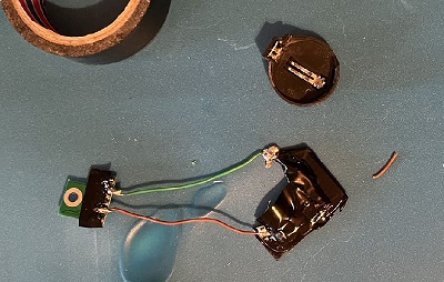

An update in case someone wants to try something similar:
I ended up using a 2032 battery as a secondary source, should last for years as it only needs to power the tracker when the laptop is off.
I installed a diode to avoid any back feeding to the usb port
Installed inside the x330
Everything ended up fitting pretty neatly without any bulging, overall I'm quite happy how it turned out
