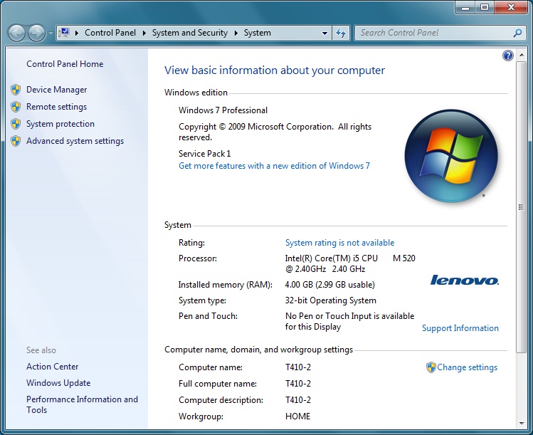

Hmmm... I just checked my T410 running with a freshly installed Windows 7 Pro from the factory restore disks and there's a Lenovo logo where I described:
http://www.kawakami-ca.com/images/W7ProSystem.jpg
I also don't see any "System manufacturer" title/section anywhere. What version of Windows is on the machine (at the top under "Windows edition")?. And while you are at the System window, click on "Device Manager" at the left side. That should open up Device Manager which shows a list of all the hardware that Windows knows about. Click on the arrow/triangle next to "Display adapters". That will then reveal a line naming your video chip controller; probably Intel HD or something like that (please provide that name when responding). Right-click on that line and select Properties. Several tabs will be visible. Click on Driver and then tell me who the Provider is and what Version is installed.
Since you are not getting any on-screen menu when you press Fn+F7 it appears you do not have the Lenovo Presentation Director software installed. You can download it for free from the Lenovo Support site but I don't think that is your problem. Also, because your LCD screen is briefly going dark and then returning to normal, that doesn't seem to me to be normal (which is why I'm asking for the video driver version).
In the event you need any of the factory utilities or drivers for your T410, you can find them here:
http://support.lenovo.com/en_US/researc ... MIGR-74582
