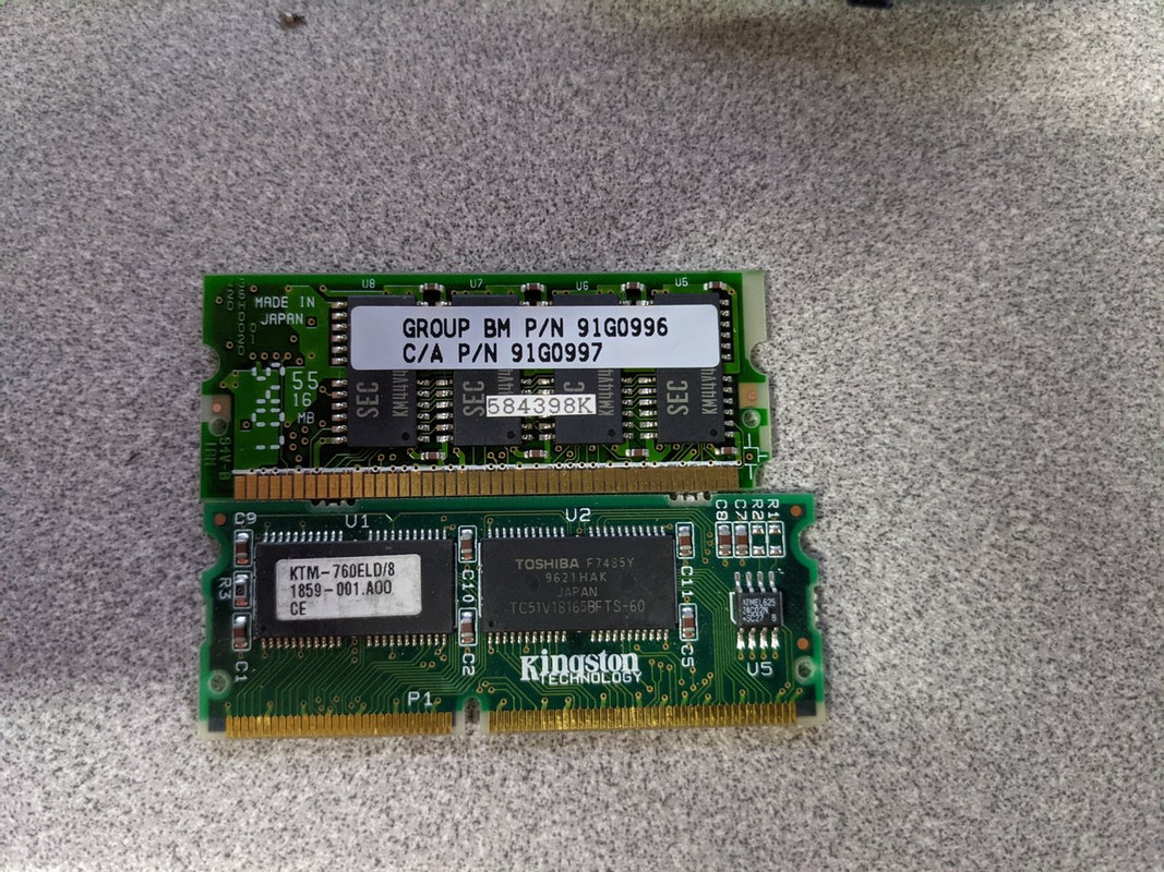

I'm also having a helluva time finding that 88 pin RAM. I can't find anything on ebay. Maybe I'll get lucky and find some lurking with all the 760E/ED/etc memory adapters I have on my shelf for ebay.
EDIT:
Got lucky and found a module. Googled the part number and it appears to be 16MB. Better than nothing.
Here's a photo of both for a size comparison. I don't have a 72 pin SODIMM handy, otherwise, I'd show that as well.
